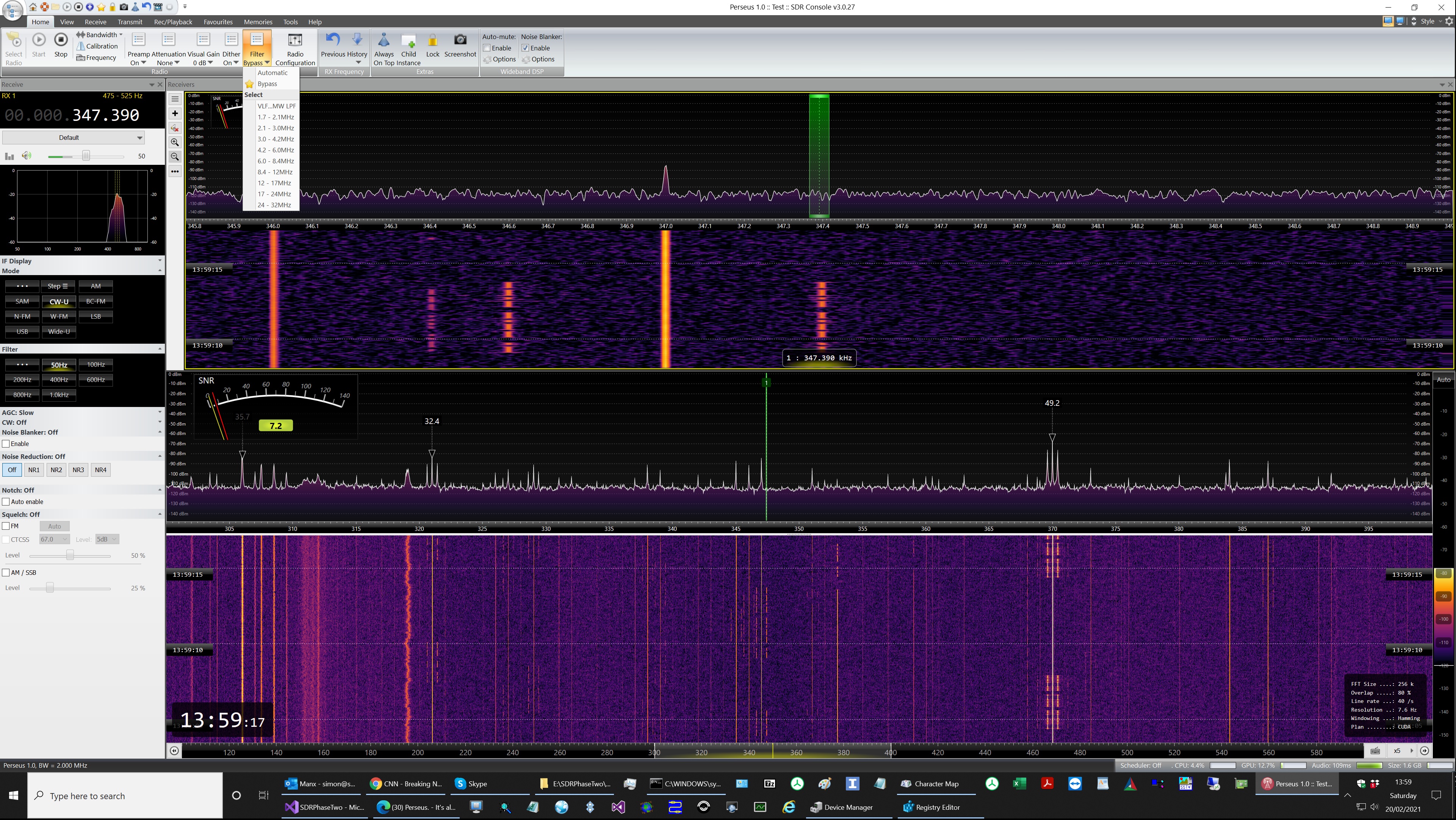

    Added a Filter menu where you can now enable Automatic selection or select a specific filter.

New Perseus UI
New Perseus UI
