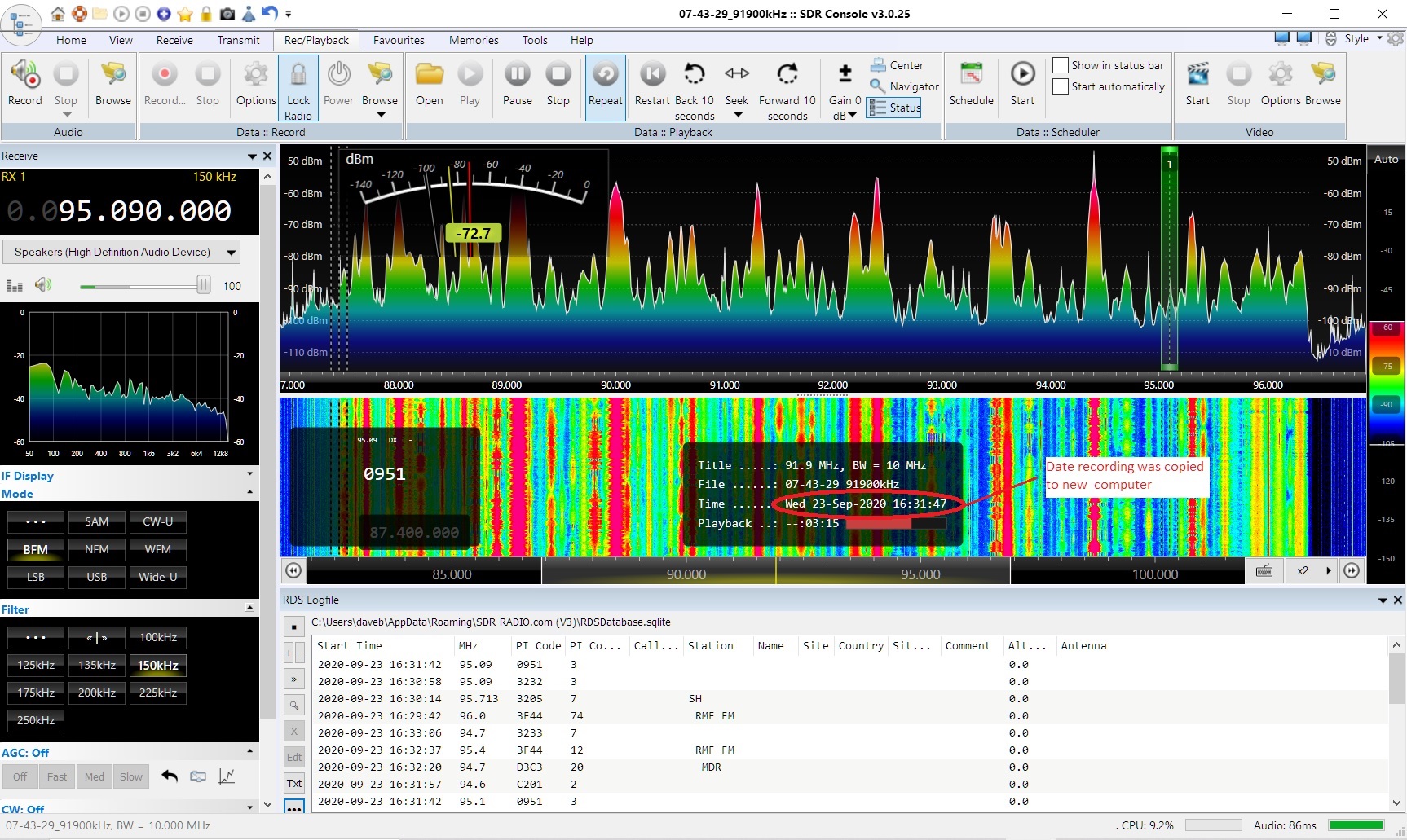

But on the next to last block of frequencies covered - SRD Console logged a PI code of 0951 on 95.1 MHz, as well C201 from Azerbaijan on 93.0 with PS: AZER FM and the same pi code on 94.6 (identified as Azerbaycan in a station announcement).
FMList.org identifies that as a Avtoradio from Tsiblisi in Georgia. (i've attached a screen shot)
As an aside - the date stamp is wrongly reported by SDRConsole because I copy/pasted the file to an archived folder on another HDD drive. For some reason Windows puts the original file date in the "Date modified" and the date copied becomes the "Date Created". This is a file recorded on another SDR program. The date was 16 June 2020.
The section of the RDSlogfile showing is of interest. The entry at the bottom showing PI code 0951 was created when 10 VFOs were running.The one at the top was with just one VFO to see if there was any improvement in sensitivity. Both lines on the logfile show that the pi code was captured three times. (The 2nd line up - PI code C201 is Azerbaycan Radyo from Azerbaijan).

Nice log, David, well done!
I had the same thing in 2017, a scan through a file recorded while I was at work dug up an Egyptian station, and more recently, Faeroes on 29th May. Console dug out the code, whereas HDSDR / RDS Spy couldn't.
The only thing I have found is that running multi receivers shows a tiny drop in RDS sensitivity over running just one receiver, but that is probably to be expected.
