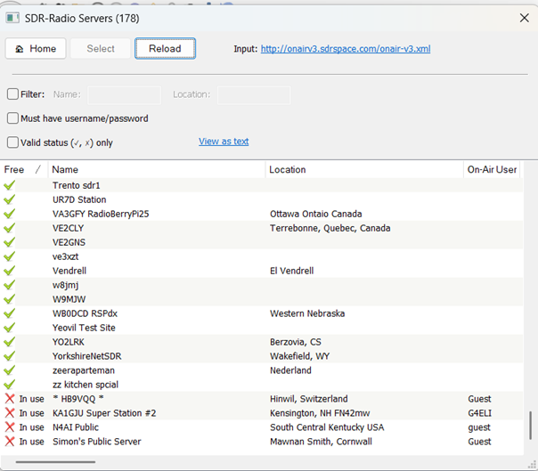

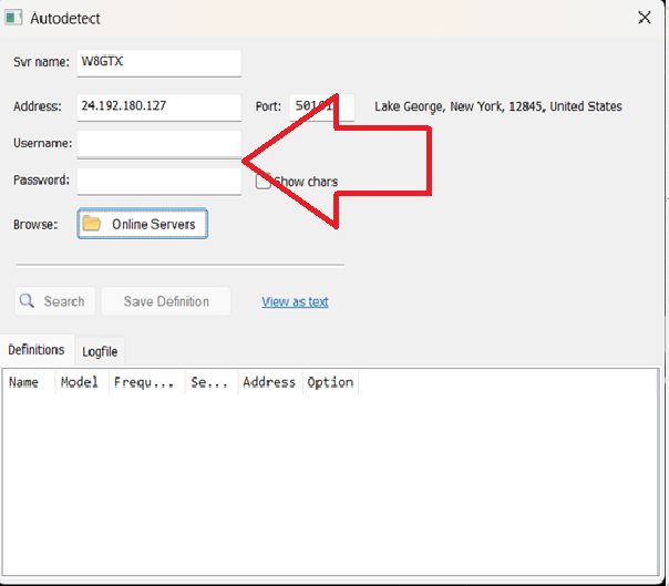

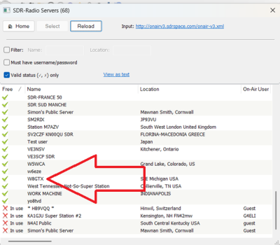

If you mean W8GTX should be showing in the SDRC V3 Server list, no, I don't see it.
Posts: 375
Re: W8GTX testing

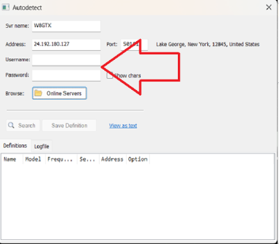

You appear on list of servers only if you search for your call, or by checking valid status. So you are reachable, but since there's no guest username/password to exchange with a potential client, no SDR's appear in the list.
Step 1: You need to make a guest account under the Accounts tab of the Server Manager. IE Place Guest or Public for the name and a simple password (this gets exchanged automatically when a client builds a definition), so keep it simple for the next step #2. While you are here, place realistic values for Maximum Connection Time and Interval Between. This is where you can make a feeble attempt to keep the SDR Hogs at bay. If you have a good location (QRM Free) and a good antenna, they will latch onto your server for 16-18 hours per day!
Typically on FT8 or on Children's Band (CB), and nobody else will be able to use it... ask me how I know!
Step 2: Then you need to place the EXACT username and password into the Default Server Account under the On Air tab. While you are here, you may enter your dynamic DNS data into the blank IP address, if you use a service to resolve your public IP. Mine changes monthly and whenever the router gets rebooted, so I use the no-ip DNS service. OTW one has to rebuild definitions every time your IP changes. Also uncheck Show Uploads if checked.
Step 3: Hit Save at the top of the On Air tab. You should see a green checkmark at bottom of screen saying ON Air Status [time stamp] OK
No Guest username and password entered

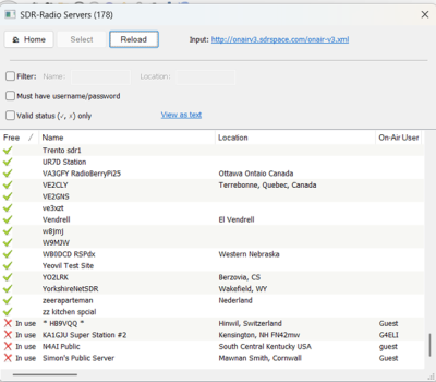

On list due to server operating, but not properly
Not on list
Not on list

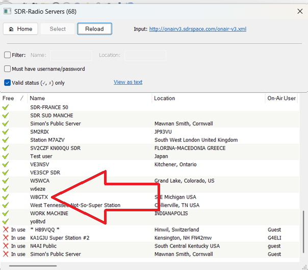

Should be fixed now. Thank you, Kriss

It's showing now. It was missing the default username/password for the guest account in the On Air tab of the manager. As of ~ midnight Zulu, it was operational. We were PMing to get things right yesterday.

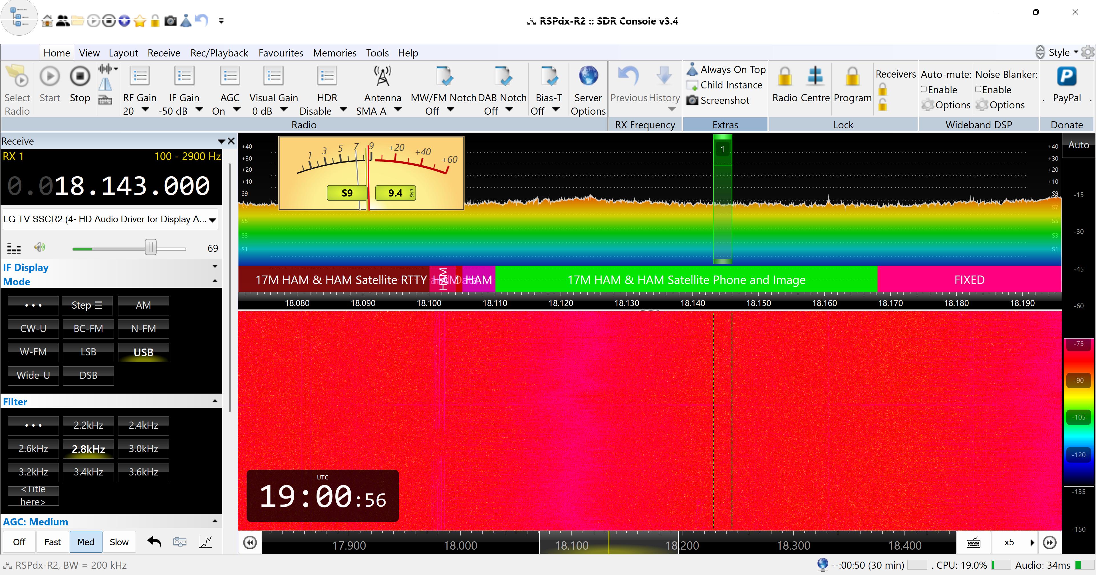

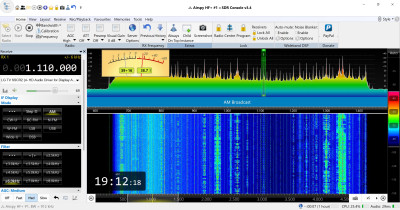

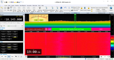

Yep, seeing that now. Pity about the heavy RFI on the lower HF bands particularly. But yes, it's working fine. Well done folks.
Must admit I did not even know there was an RSPdx-R2! Out of interest, what level of Visual Gain setting gives S0 noise with no antenna connected on the 80m band?

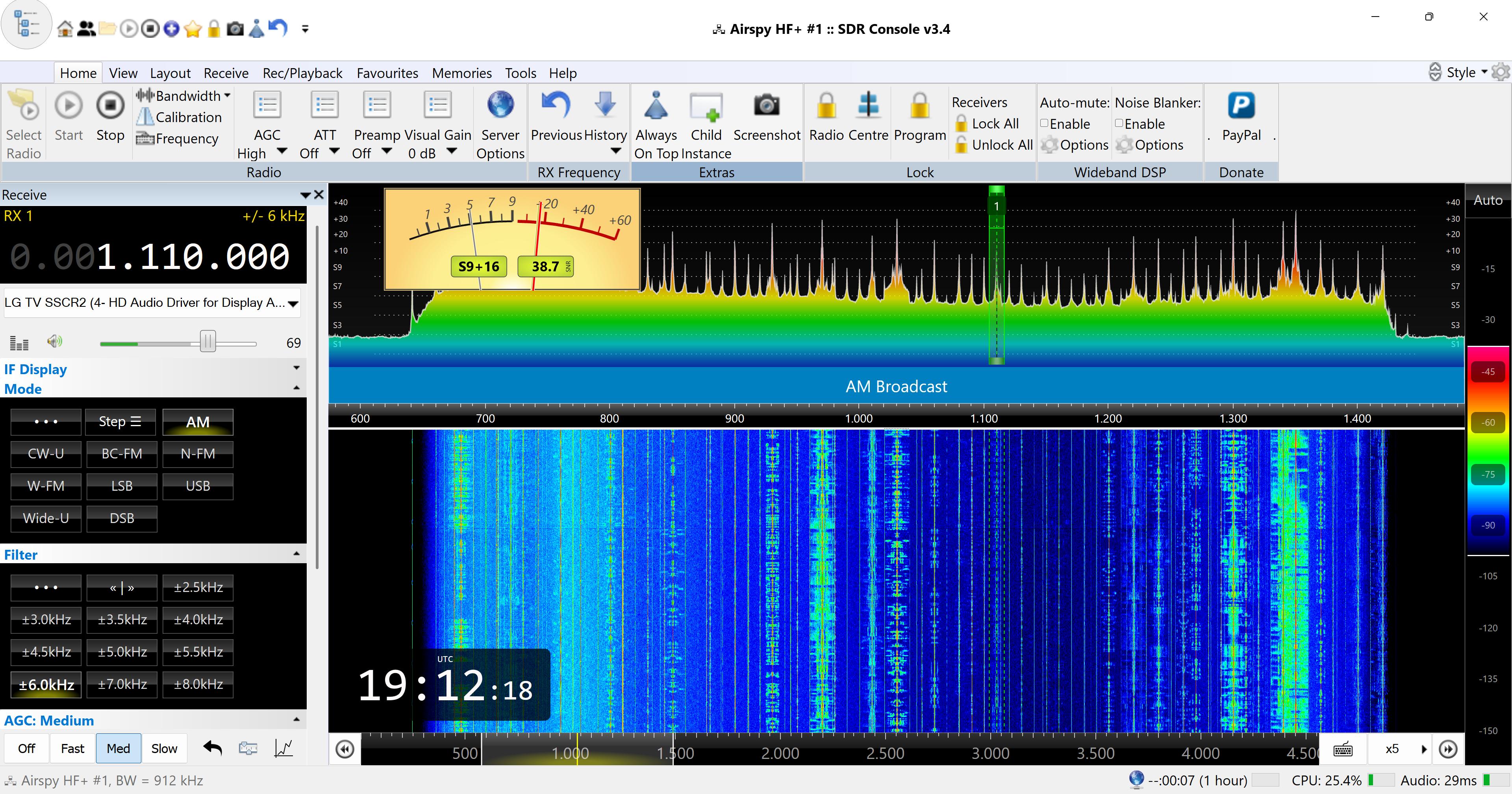

Always fascinated to see the AM stations still going on the broadcast AM band in the USA. Here in the UK there are few state broadcaster (BBC) stations, I guess mandated by the UK Gov, but local activity all but ceased, often due to the cost of power to run the transmitters versus the tiny number of listeners!

I was discussing that with him last night. The default gains are a bit too much.
Upon first connection!
Needs to put some data in the server manager to give us a hint of what's the realistic settings should be.
That way it shows up in the Server Options tab, under Station Description.
The other pic is a 5KW AM station in Salem, NH as heard in Freedom, NH ~70 miles away.
We have AM stations every 10KHz at night, almost the same during the day.
AM station at 1500 local!

Unread post by W8GTX - BDM »
