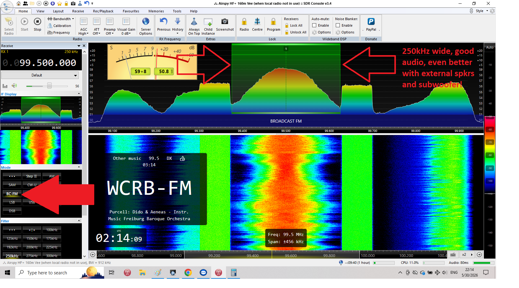

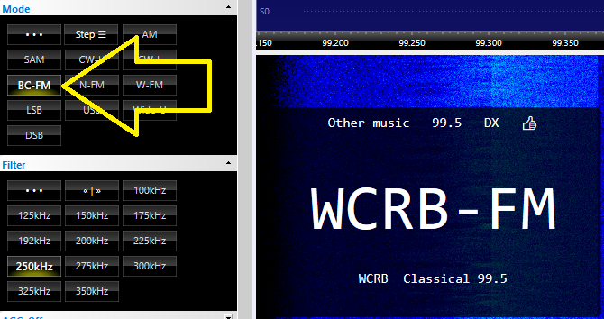

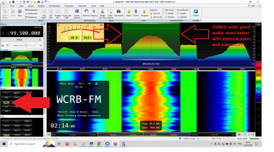

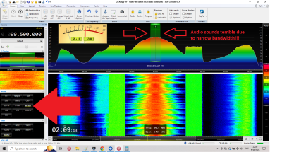

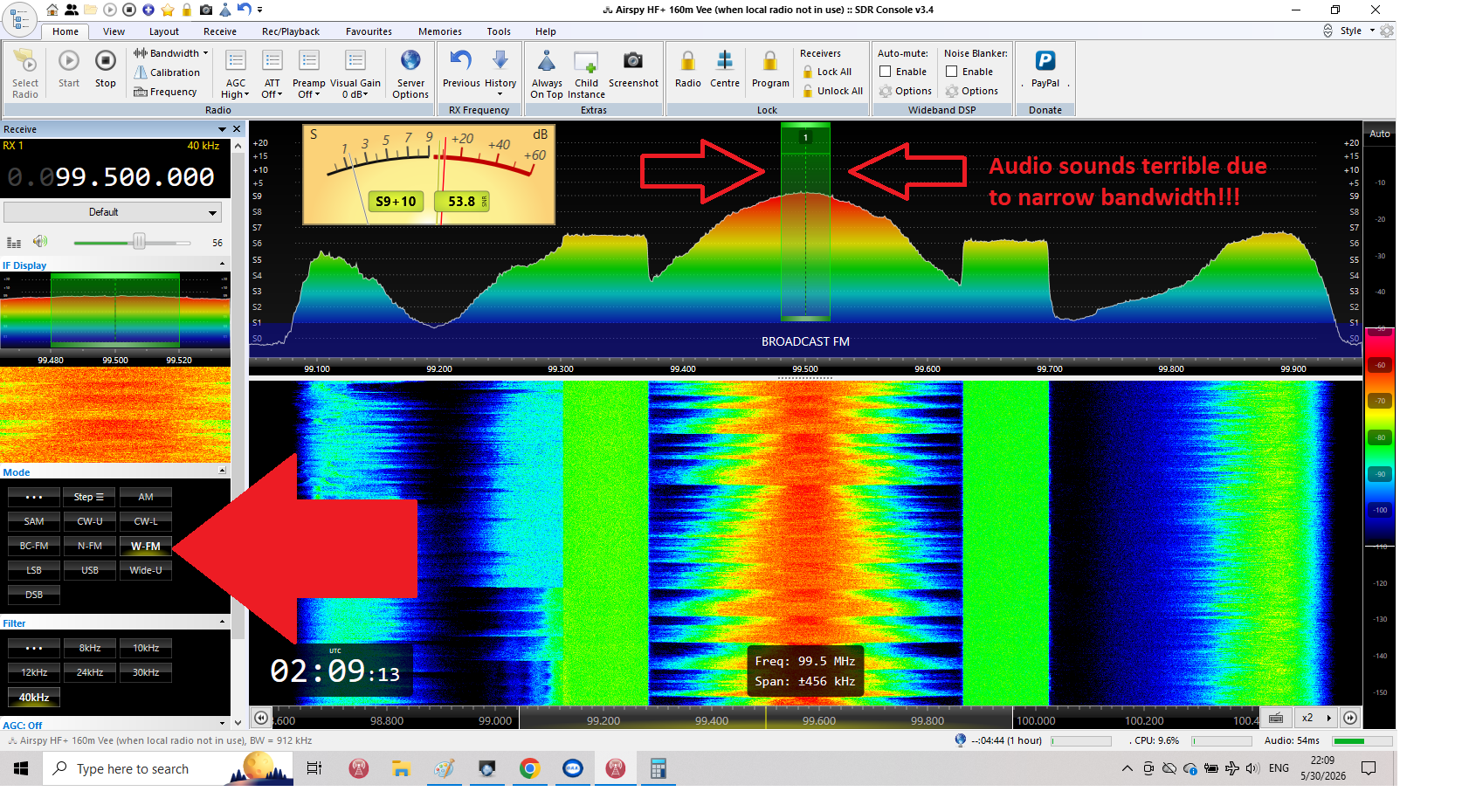

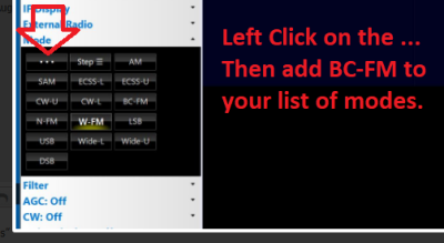

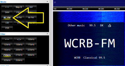

One thing that stands out is you are not in Broadcast FM mode (BC-FM) (See attachments). Your DSP panel says you have W-FM selected, which is only 40kHz wide. When you select BC-FM, it will default to 250kHz! I have attached two images (BC-FM3.png) and (W-FM.png) to show you just how wide BC-FM is. The sound with amplified PC speakers and subwoofer are awesome.

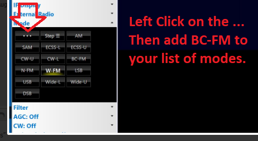

Left click on the three dots and add BC-FM to your list of choices (BC-FM.png), while there, you can remove those you will probably never use (ECSS-U, ECSS-L, Wide L, Wide U). I use DSB to calibrate the SDR's frequency via WWV, so you may want to keep that one. This will free up some space in the DSP window for the AGC, Filters, NR, NB, Squelches, etc. (BC-FM2.png)
