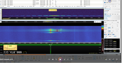

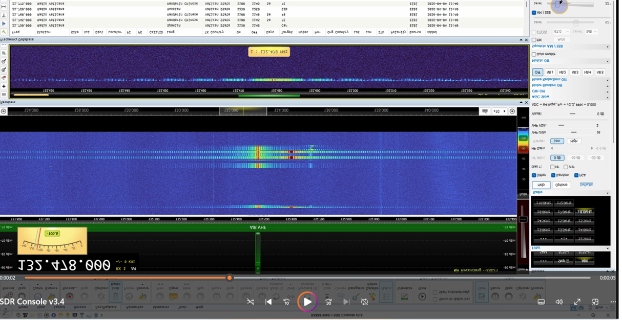

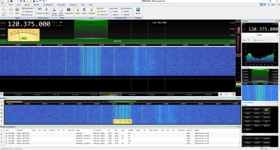

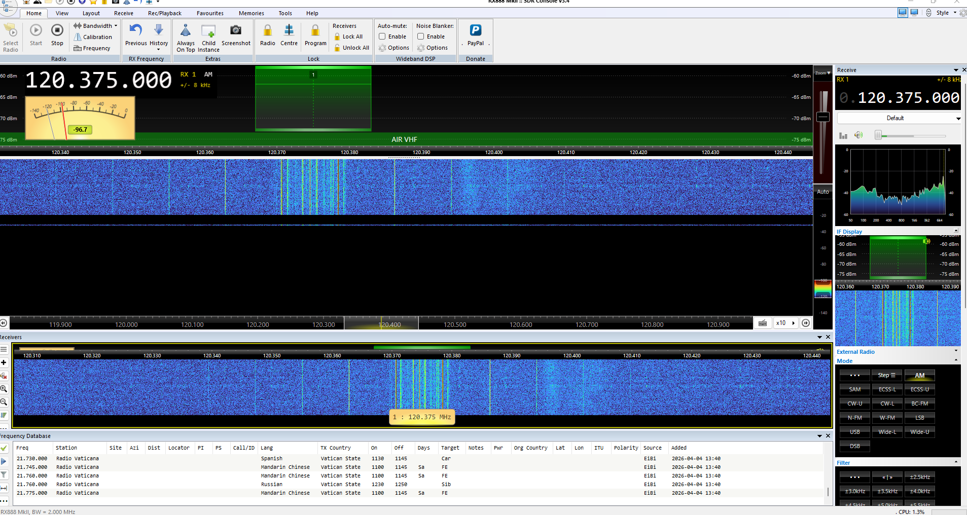

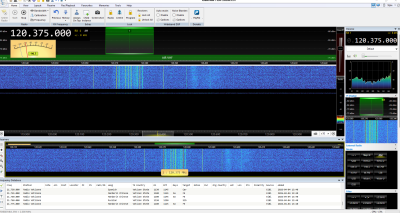

Now when I start SDR Console it takes quite a while to start up and once done the sound of white noise is somewhat stumbling, stuttering. When there is a signal eg AM received the voices sound like mickey mouse voices. And also the waterfall looks mirrored like 200kHz to both sides, lot of times.
I recorded a short audio and video. Not sure where or how to post this? Ah did it. Anyone knows what happens or better how to solve? Has my RX888 MKII suddenly a defect? It hasn't been moved...

I am aware of the mirror of upsidedown view of the video. I do not know why that happens as well. Just used the record button in SDRC. Is that not normal? Any idea why that would have happened? I presume that is what you mean by not-viewable? I thought a video would be more of use than a screenshot.

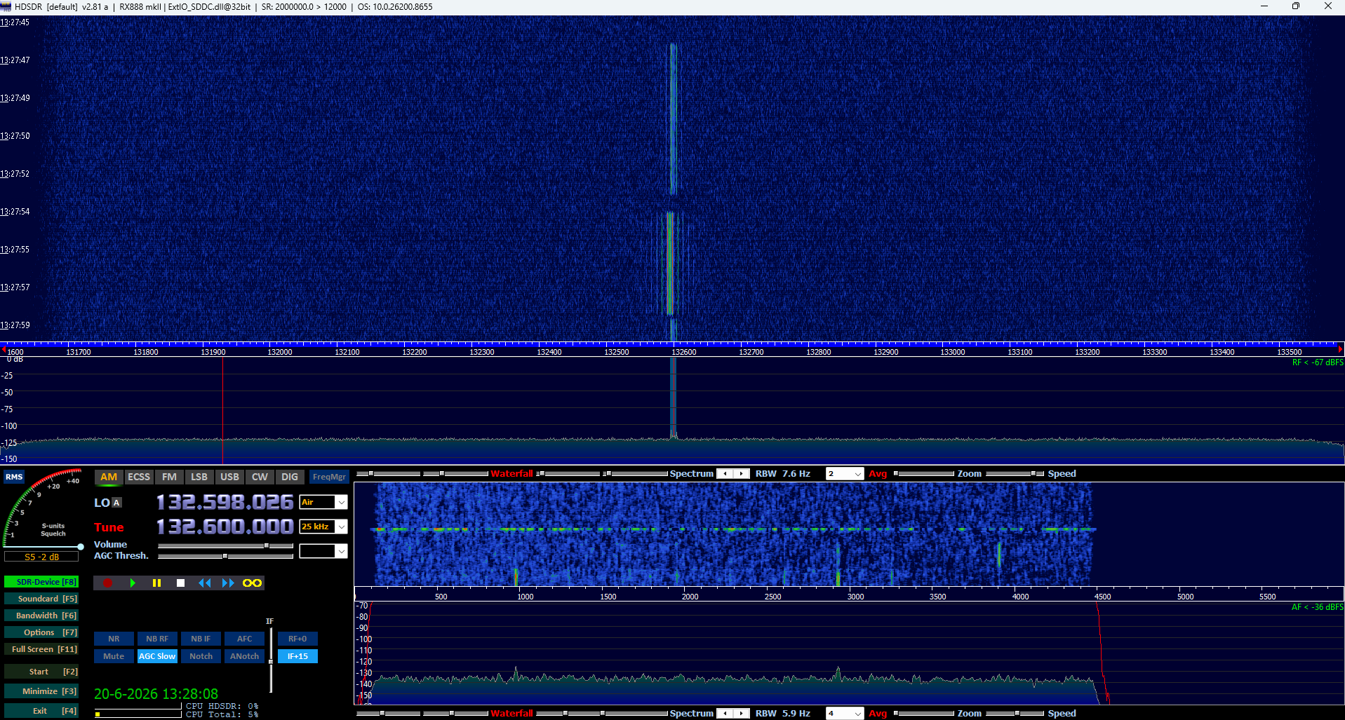

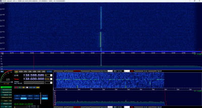

Seems like HDSDR as well has abnormal behaviour on the RX888MKII, see screenshot.
I'm coming to believe that there might be something wrong with the RX888MKII ? But what could have happened. Maybe anyone has any similar experience with these symptoms?

When I play the videos, they are upside down and backwards!

Firstly, no a mirror/upside down of video recording from SDRC is not normal. Got no idea why this is happening. Are you posting the raw video as recorded by SDRC or have you processed it in some way? Never recall seeing this behaviour mentioned previously.Steef wrote: Sat Jun 20, 2026 11:32 am Seems like HDSDR as well has abnormal behaviour on the RX888MKII, see screenshot.
So turning to the other "mirroring" i.e. the signal mirroring, this behaviour on an SDR is usually caused by either a large imbalance or a total loss of either the I or the Q signal. If you see the same behaviour on HDSDR then my guess is that it's more likely a hardware issue. Have you checked/substituted cables (and also see comments below about USB ports)? Although to be fair I doubt that this could be caused by that, but anything is worth a check. A poor quality cable or USB hub/card may not deliver enough power for the RX888 (again, see below).
The only thing I would add is what I see from your screen grabs does not look like mirroring. If you look closely you can see the signals are not an exact mirror either side of the tuned signal. If it was mirroring I'd expect it to be a perfect mirror.
As it has been previously working I'd say the likeliest answer is hardware failure of some sort. I do know the RX888 is prone to overheating especially when used at high sampling bandwidths and it's not unkown for the to fail accordingly.
