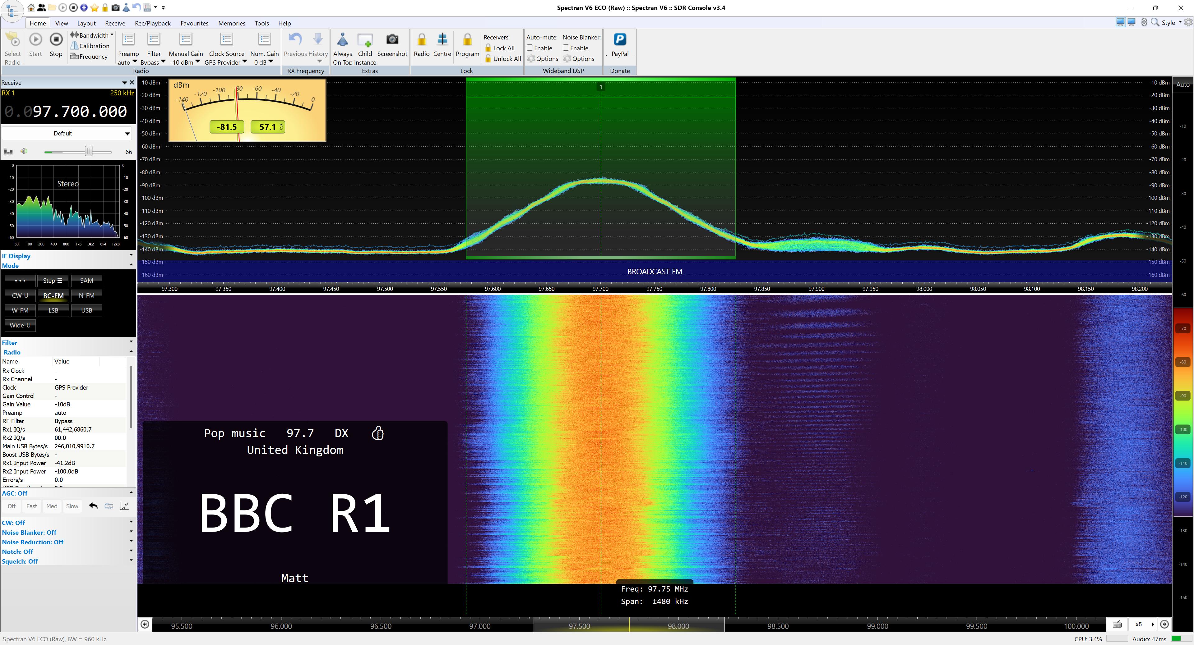

So,
It's OK down to 960kHz bandwidth. New kit this week.
