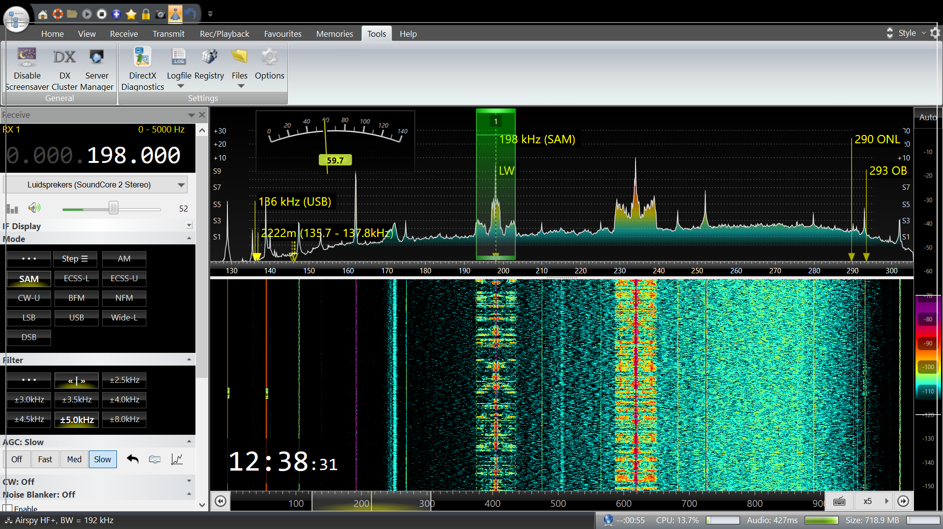

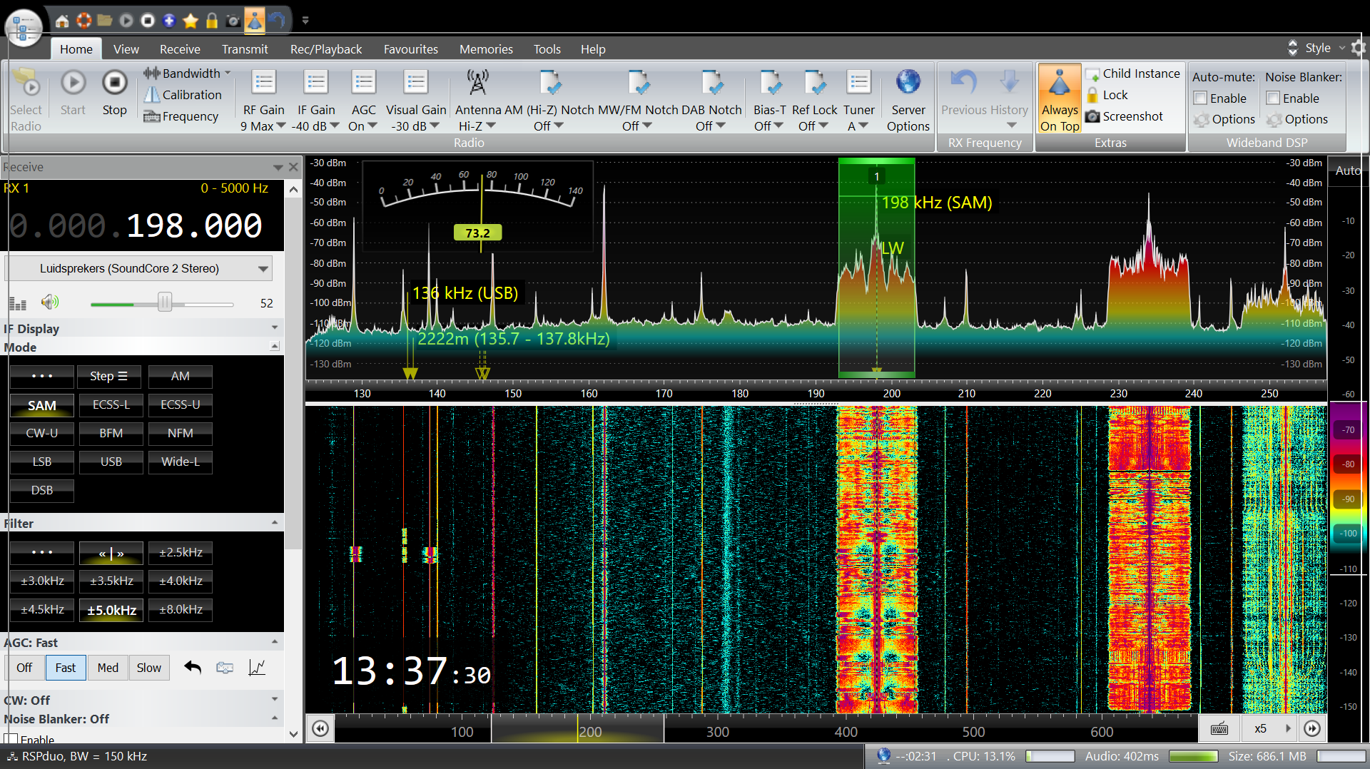

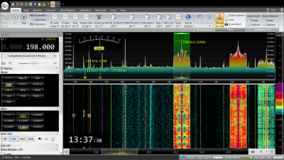

Tried the audio driver update from Microsoft link, but no luck. After this I rebooted and connected the Bluetooth Anker Soundcore2 speaker but this had the same problem. So my guess is that it must be pc related. When starting the Console the low CPU load from 1.3% started to incline to 13.7% and so was the audio latency from a 26ms to 427ms and fluctuating between 350 and 400+ for the rest of the time. This is the latest build v3.0.26 both on the server and the laptop. Choosing a smaller sample rate lake 50 kHz did not make a difference.
Maybe I forgot to mention that this laptop is always using a Wi-Fi connection on the server. I tested another laptop with the same Wi-Fi router and identical settings which did not show any problem, even on the 500 kHz sample rate of the RSPduo. So this problem does not show on any of the other pc's.
Here is the logfile and a screenshot.
73' Ron
