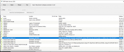

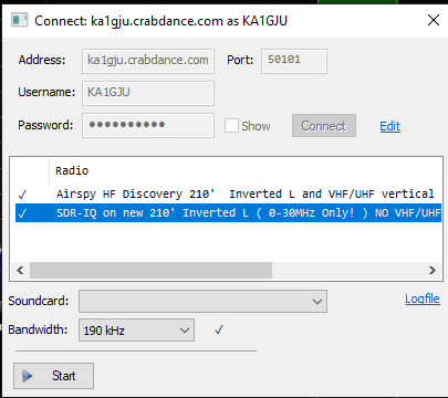

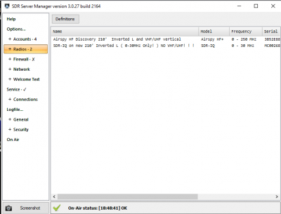

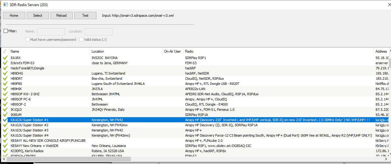

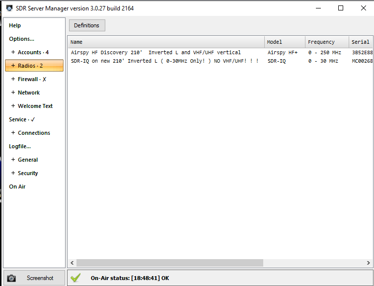

1) You have 2.6GHZ to 2.8GHz in the settings try 26 MHz and 28 MHz
2) If the restriction is due to the antenna, you can mention the limits in the radio definitions like I do. When a user connects, they will see the limitations on the server and why.
3) You can also place comments in the Welcome Text tab (although few users probably use that info) so if they click on the Server Options in the home tab of SDRC, there's an option titles "station". The text you enter in the Welcome Text tab will show up there.
4) If you place text in the On Air Tab, the user will see that data while building definitions and can decide if they want to build a definition with the restrictions.
Excuse the order in which the images appear, RadioDefinitions should be first, radiodefintion2 next, then #3 last!
