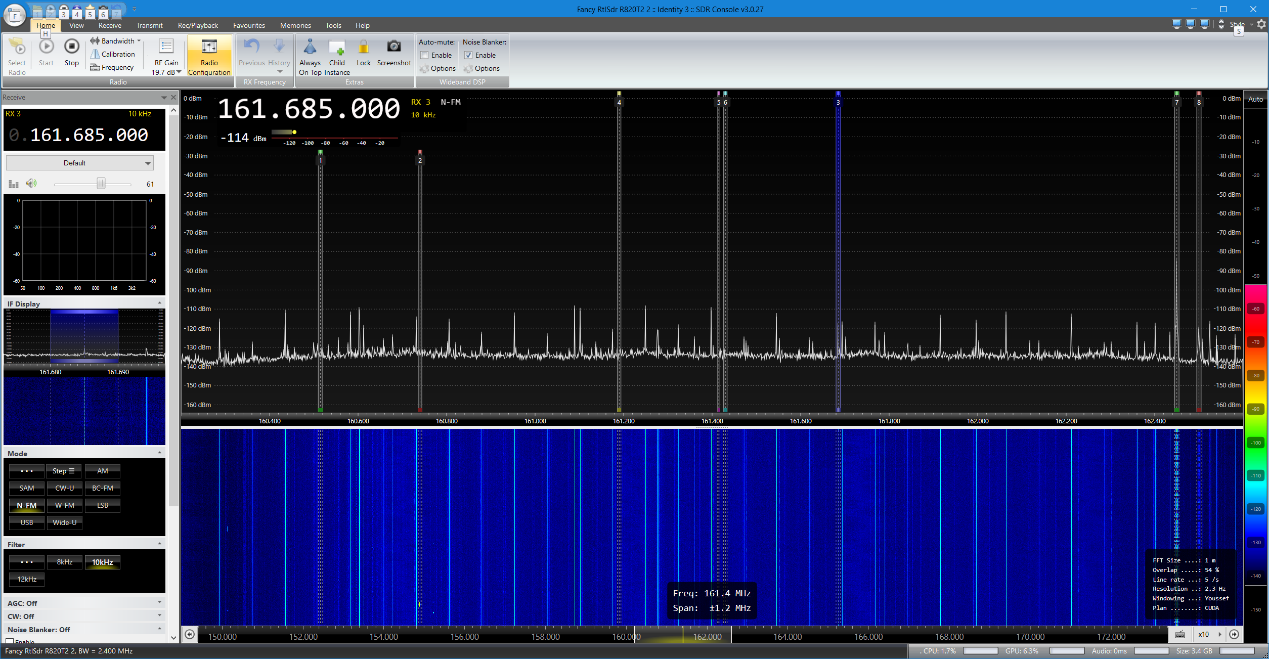

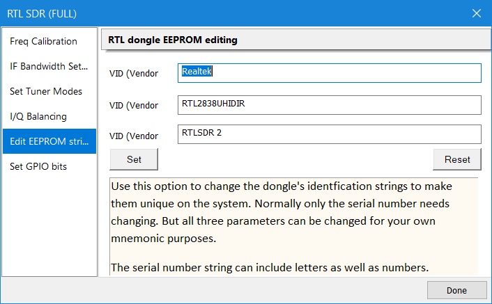

With great caution you can get decent results with great care you can use my RTLTool. It is best used very judiciously.
But, if you follow your nose (and rtlsdr settings.jpg) below you can select "Radio Configuration", highlighted in the menu bar in this picture. That brings up the rtlsdr configuration property pages dialogs. Select "Edit EPROM stri..." and get the page shown. The only line you want to diddle is the third line where I have "RTLSDR 2" for the dongle selected. (The noise in the first picture is because it is on a test antenna in the computer room.) You are limited to around 200 characters. But, for sanity's sake make it short like I did. It is really an identification string more than a serial number string. As you can see, the string can have any 8 bit ASCII characters in it. (I now RTLTool would be unhappy with Unicode. But MAYBE Simon made UNICODE work. Personally, I would not try it to maintain compatibility with other tools.)
