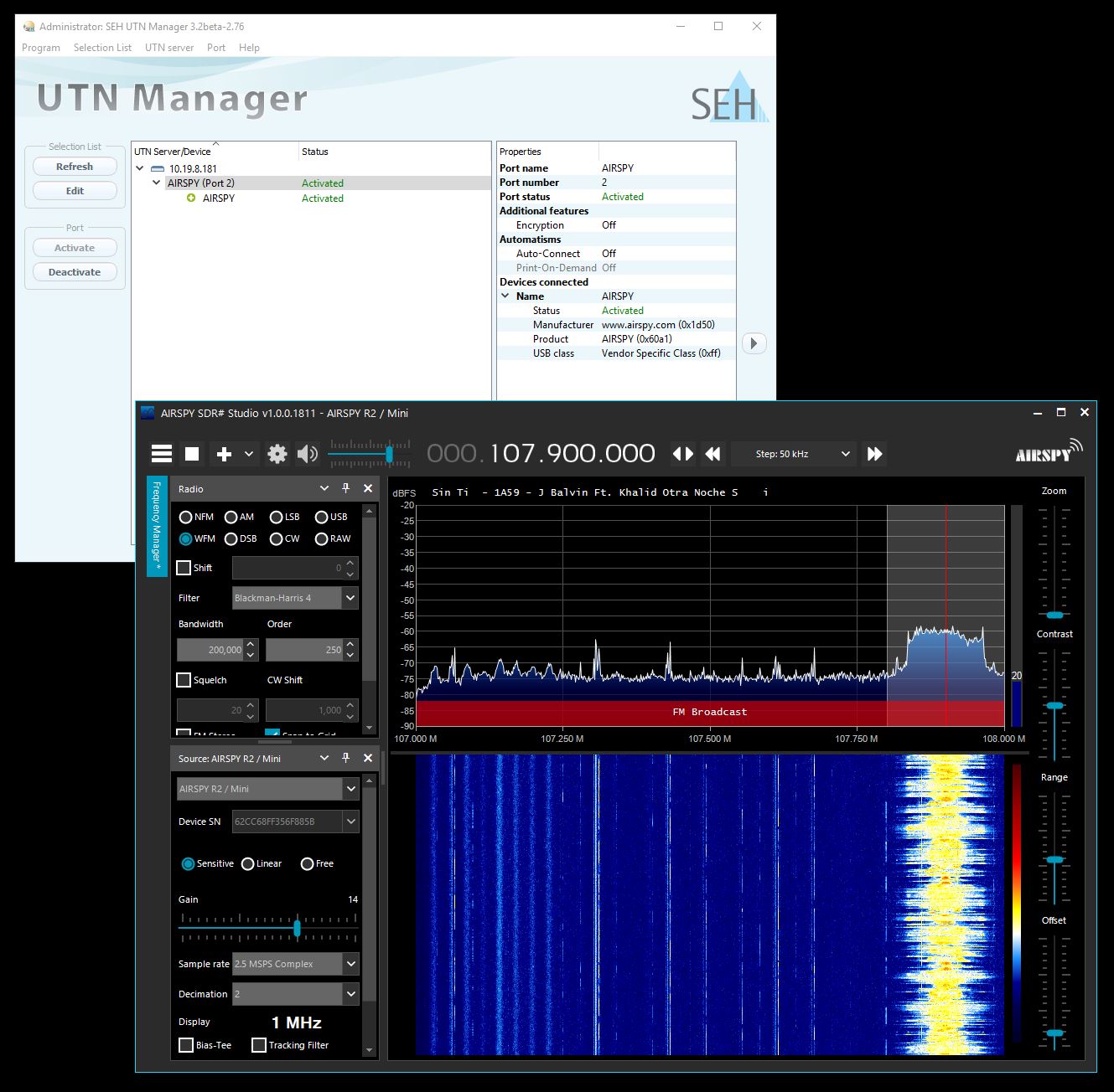

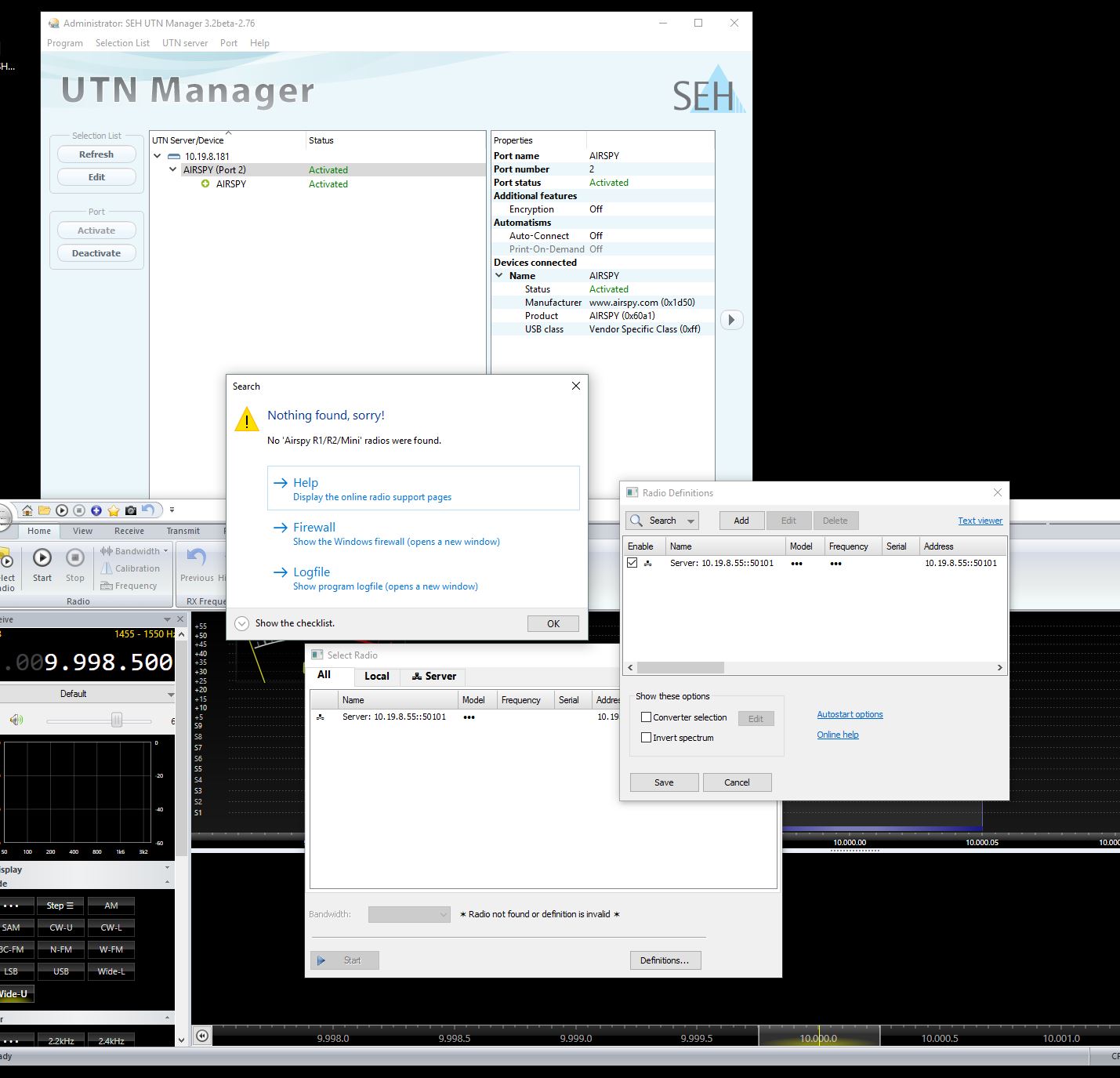

In support of the bug request I'm attaching a screenshot of the R2 being recognized by SDR# (after updating libusb.dll to the latest version) and not recognized by SDR Console.
