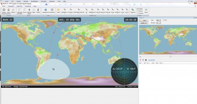

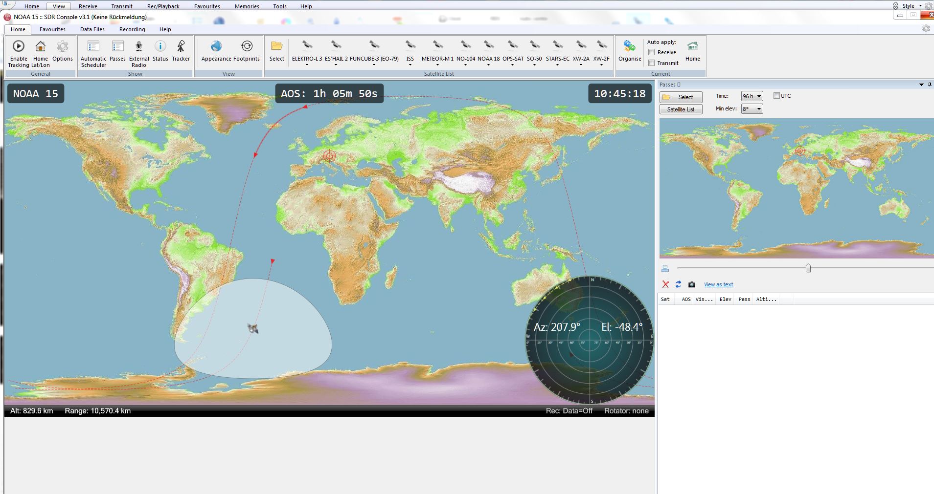

I have a problem with the satellite tracker. By mistake I have set 96 hrs in the Time window.
Unfortunately, I can now no longer access the setting after calling the tracker because the prog. immediately after the call to process the data. Unfortunately, there is not enough memory and the program crashes.
Is there an ini or a config that I can edit to reset the time?

Win start button, go to SDR-Radio Tools and try reset console and pray ;)

That should do it. I assume this is a 32-bit version of Windows? If so don't start the radio, close unnecessary windows to get the memory down.

I deleted all SDRSat Flies and restarted the system.
Works again everything as usual.
A reset button to default or a start button in the tracker menu would be very helpful.
