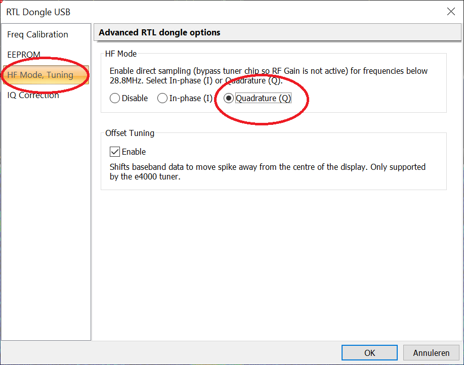

Re: DX Patrol MK4 SDR Radio - No HF
Use zadig and add it as RTL stick v3 in SDR Console (the name is not SDR Radio)
Then look under the button Radio Settings for the setting in attached picture.
Please let us know if this helped you. 73, Leon

Thank you Leon. After sometime away, I've retried with the latest version of Zadig and SDR Console and it now works. I just need to invent a new stealth antenna... I'll be on an airbnb for a the next months and it would be nice to SWL.
Thanks both for the support.
