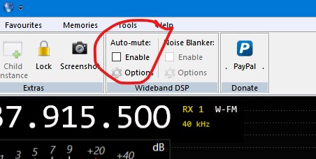

To me this sounds like you have a very strong local signal somewhere near 20MHz triggering Auto-Mute. Make sure you have this unticked? Has caught me in exactly the same way due to local MF transmitter. So my guess is reducing the bandwidth excludes the offending signal from the passband?
https://www.sdr-radio.com/wideband-dsp

Max wrote: Tue Feb 15, 2022 11:39 amTo me this sounds like you have a very strong local signal somewhere near 20MHz triggering Auto-Mute. Make sure you have this unticked? Has caught me in exactly the same way due to local MF transmitter. So my guess is reducing the bandwidth excludes the offending signal from the passband?
Thank you for pointing me to the right area.
It was actually the noise blanker rather than the auto muting.
If I turn off the noise blanker, everything is working as it should.
