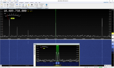

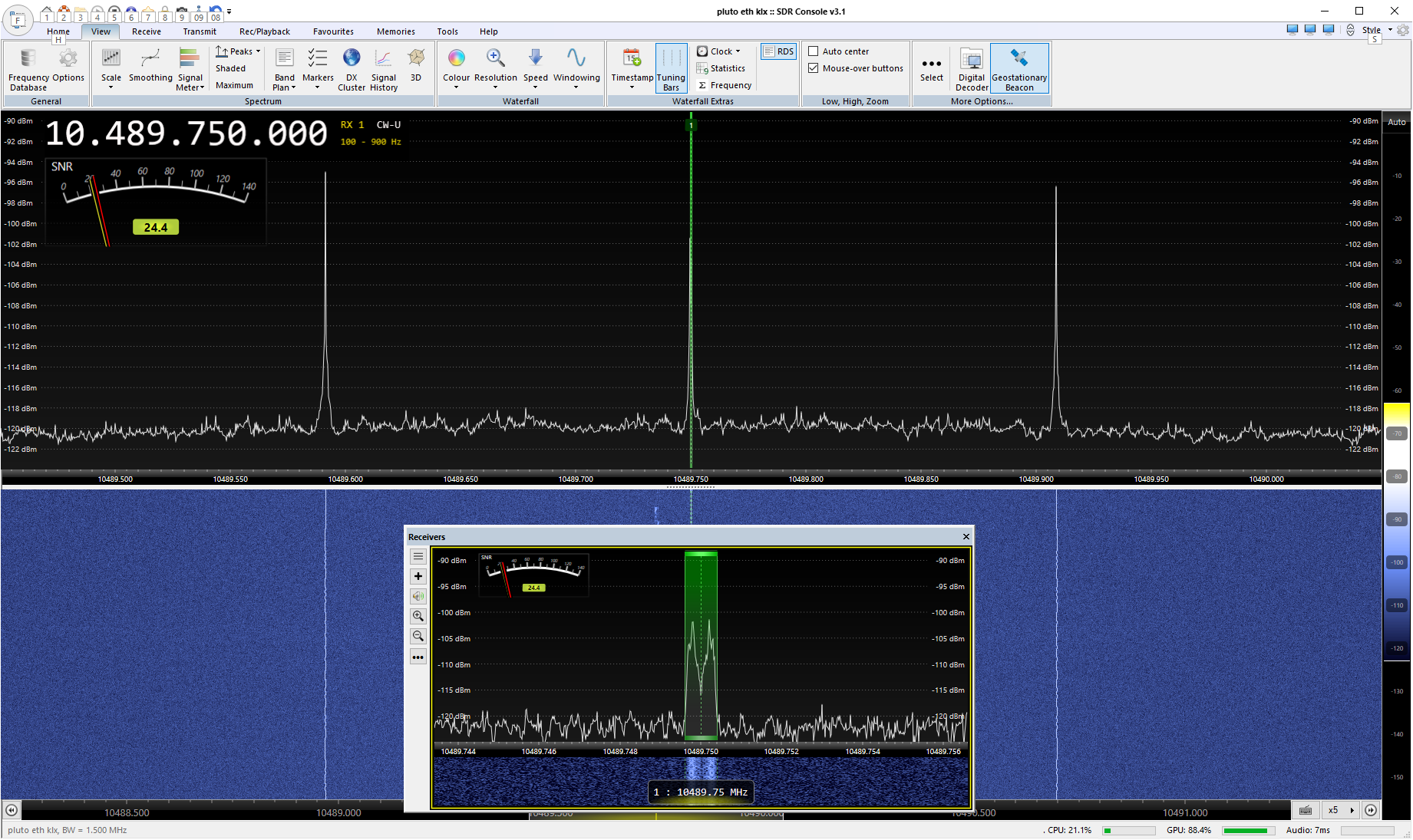

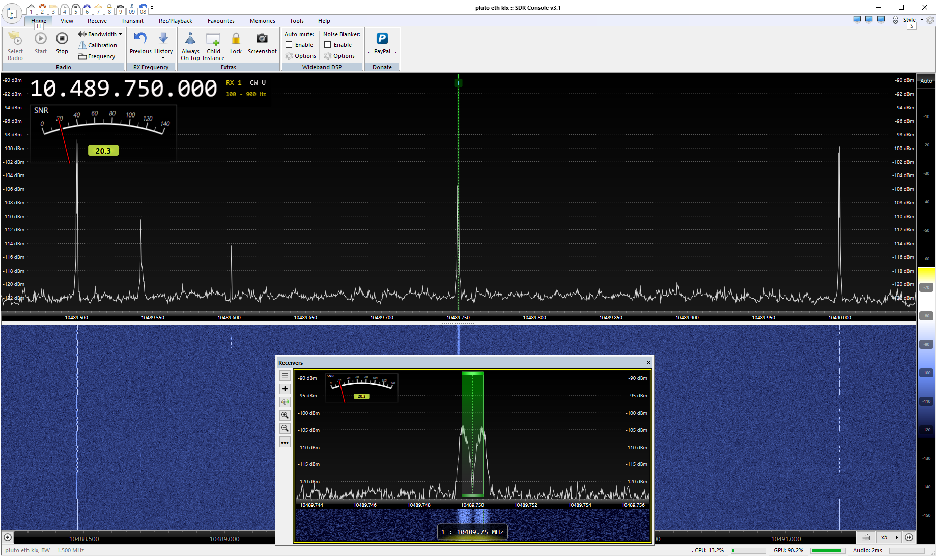

but when I connect again with SDR console i got the beacons at wrong frequencies and somehow the whole spectra is compressed, the audio is not good either. see attaced printsceens

It looks like you have different settings in the two pictures. Since nobody can see what your settings are but you it's pure guesswork. (Show the settings pane. Flood us with data. Too much is better than none at all.)
In the mean time make very sure you have the GPSDO set to 40 MHz. And also test on a different SDR program like HDSDR to see if it agrees with SDRC or with what you think it should show.

I solved the problem, the strange behaviour was caused by to strong 40 MHz clock signal from the GPSDO. When I added a 6dB attenuator to the clock signal all was OK again.
The settings in SDR console was exactly the same in both cases so it looked really strange.
