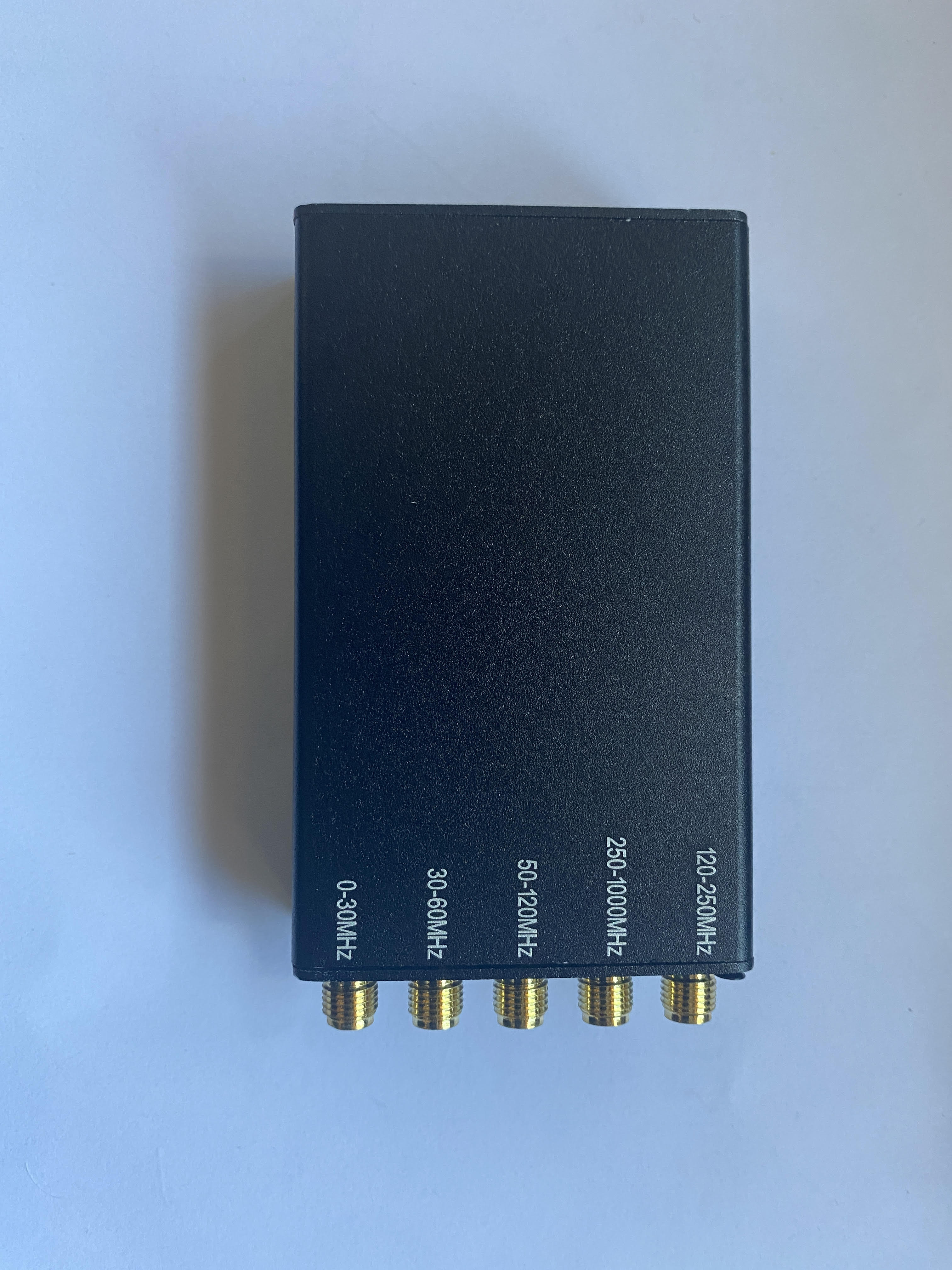

I have a new SDR Module I purchased from WISH.com via Store TINAMILY it has 5 SMA Antenna inputs and it covers from 10Khz to 1 Ghz but I don't know the brand or type it is so what definition do I assign it to use with SDR Console??? I am new to SDR and excited to get to using it....I sure could use some help... I have included a photo of the Module as .jpg image of it.

Looks like a RSP1 clone
see https://github.com/EndlessEden/msiSDR/tree/RSP1-S
So it should probably work using SDRplay settings in SDR Console ...
just my guess - hope it helps.

Pete....You pegged it for me Thank YOU.

I installed SDRUNO and alass it works!!!
