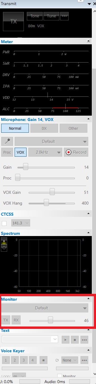

On the transmit panel look for what I have outlined in red. If either of those monitors are on results could be counter your expectations. The monitor function set on for TX could give you what you are hearing, I believe.
TX Panel.jpg (85.1 KiB) Viewed 2990 times

jdow wrote: Wed Dec 27, 2023 6:52 am Bingo - with the explanation all in one place and with the added information my memory got keyed.
I had thought of that Joanne because I use that monitor all the time with digi modes, but he did clearly state that he can still see s9+++ signal on the spectrum/waterfall so I ruled that one out? Unless I misinterpreted his description?
Re: Mute doesn't, well, mute...
#16
jdow wrote: Wed Dec 27, 2023 6:52 am On the transmit panel look for what I have outlined in red. If either of those monitors are on results could be counter your expectations. The monitor function set on for TX could give you what you are hearing, I believe.
Also that panel is for monitoring audio input to the SDR, and he is using a separate boat anchor TX so AFAIK he would not (should not?) hear anything from that panel regardless of selection?

Good point - pictures showing control settings tell the story. If he is monitoring at IF frequency of his transceiver, for example, it is unlikely he'll be able to use muting effectively, especially if his front end has an AGC of its own - but then the transceiver's IF would still be infected with the Transceiver's AGC.

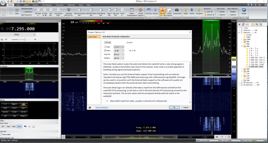

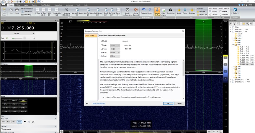

Mute Settings
Mute Settings
Console not muting my strong signal
I played with all the settings tonight. No deal. It appears to mute all signals except my transmit signal. This was all through the MFJ-1708B SDR TX RF Switch and a DX engineering receiver guard. I also tried to transmit without the receiver guard and still no muting.

You van see my transmit signal inside the green area on the waterfall/FREQ display in the first photo.

w3kw wrote: Fri Dec 29, 2023 3:31 am Picture2.jpg
Thanks all.
Wes
Two things. Firstly can you please post the pictures as attachments instead of inserting them as images. It's a bit hard for me to read as I can't see the pictures full size..
Second thing that hit me. I don't have RSP Duo but I have RSP2Pro and also have played with some other RSP receivers on the servers and they seem about the same so I guess maybe the Duo is too...... you seem to have Visual Gain set high. IMO this will have the effect of limiting the dynamic range of the receiver.
Remove antenna from the Duo input while tuned t the frequency you intend to operate on. The RF and IF gain settings don't look too unreasonable. Can't quite see from the pics but looks like RF 4, IF -25. SO with antenna removed, then set Visual Gain to give S0 signal strength. Then reconnect antenna and try again.
Others opinion may differ, but to me it looks like with the Visual Gain setting as you have it (and remember this will affect trigger levels in the Mute control panel) there is quite possibly too little differential between normal RX signal level and the heavily overloaded receiver when in TX mode.
Maybe try that and see how you get on, and also with Visual Gain set this way, try the Mute with Peak enabled as well and with threshold levels set as recommended in the "Help" notes of the Mute panel.
