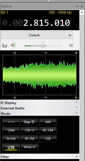

I then noticed by checking all settings and comparing it to what you showed me and I found that I still had the external radio option selected :roll:
I had not seen this before, probably because the radio box was minimized.
After I unchecked this option and restarted SDRC things started to work the way I expect it to.

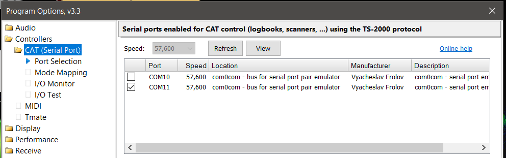

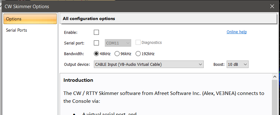

Still I have 1 question: When I look at the CW-Skimmer option dialog panel you see that you can enable it, but there is also a COM port setting.
What is different to this COM port versus the COM port that you can set in the general options panel?
I added the 2 screen shots for clarification.

As far as I am aware these two screens are totally independent of each other. The CWS setup page defines the port to use purely for CWS.
The other COM ports page is to reserve/set COM ports that communicate directly with logging programs, WSJT-X etc etc. So in other works, say you've used COM 11/12 as the pair for CWS, then you do not want either of those checked in the other COM ports list as they are already spoken for by CWS. That's the way I understand it anyway.
I tested this and what I discovered it that you can use both tick boxes at the same time. So you can have CWS enable tick box "ticked" and leave the COM port tick box "unticked" as long as you have it set in the general options. Or you have it set in CWS options or even in both places. I guess that Simon just wanted to group some essential settings in one place. In this case for CWS.
You can use multiple programs ast the same time connected to SDRC as it is Omni-Rig that is the interface for all of them. Each program connects/talks to Omni-Rig and Omni-Rig in turn

Hi Rudy. Yes, I think that's true unless you try and communicate with another program (WSJT-X for example) on the same port you allocate from SDRC to Omnirig. But if it's only allocated to Omnirig and has no other conflicting traffic on it then as you say it does not matter. For me I will tend to keep the the pair of ports allocated to CWS unticked to avoid any conflict.
