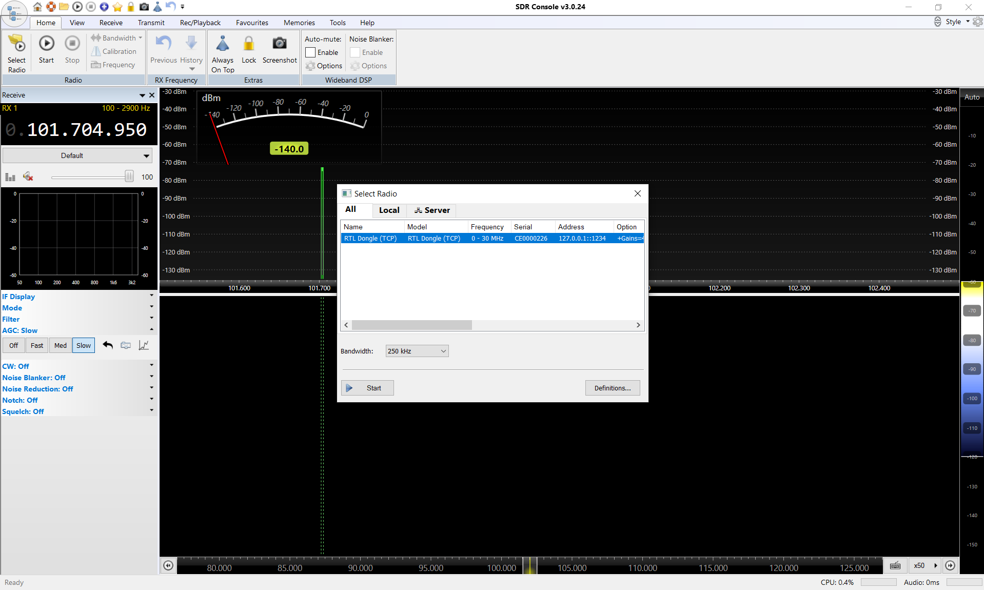

As shown in the attachment does RTL Dongle(TCP) is right?

No it isn't right. Zadig installs the USB driver for the RTL-SDR. You have selected RTL Dongle(TCP).
If the dongle is connected to a USB port on the same PC as SDR Console then you should be selecting RTL Dongle(USB).
If you have the dongle connected to another computer, tell me now.

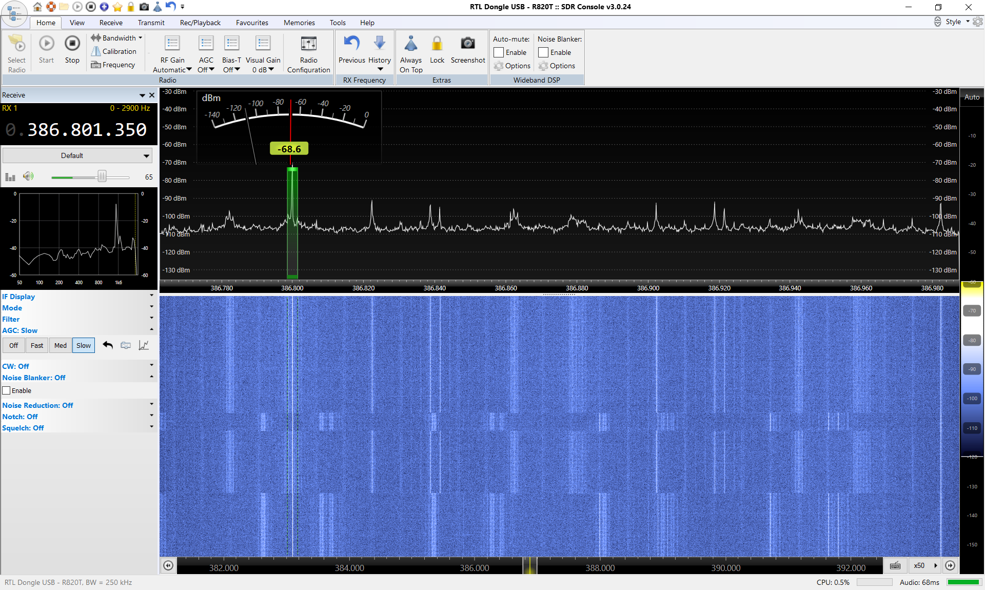

Finally, I can run it with RTL Dongle(USB) without a problem.
I took a screenshot of my status.
Now, a beep noisy sound has been heard from the speaker.
How can find it is in FM modulation or AM modulation?
How can I switch it to AM 730 or Airplane communications?
Thanks again.

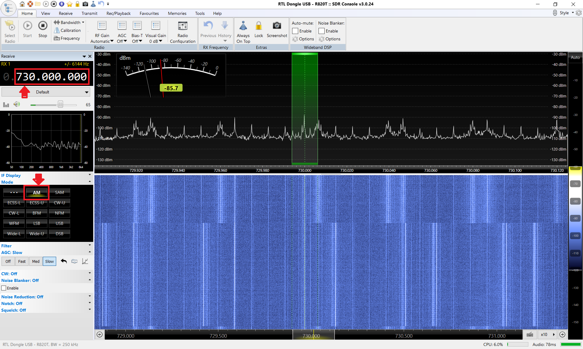

I have read https://www.sdr-radio.com/receive-dsp but still, I don't know how can I set the receiver to AM 730 kHz?
I have attached my current status.
I don't know what is the meaning of 730.000.000. Is it 730 MHz or 730 kHz?
Also, Does my setting set to AM by the arrowed button?
Thanks again.
VK5HI
Posts: 9
Joined: Sat Aug 08, 2020 11:41 pm
Re: SDR Starter problem
#18
Unread post by VK5HI »
You are tuned to 730 MHz.
Regards. Colin VK5HI.

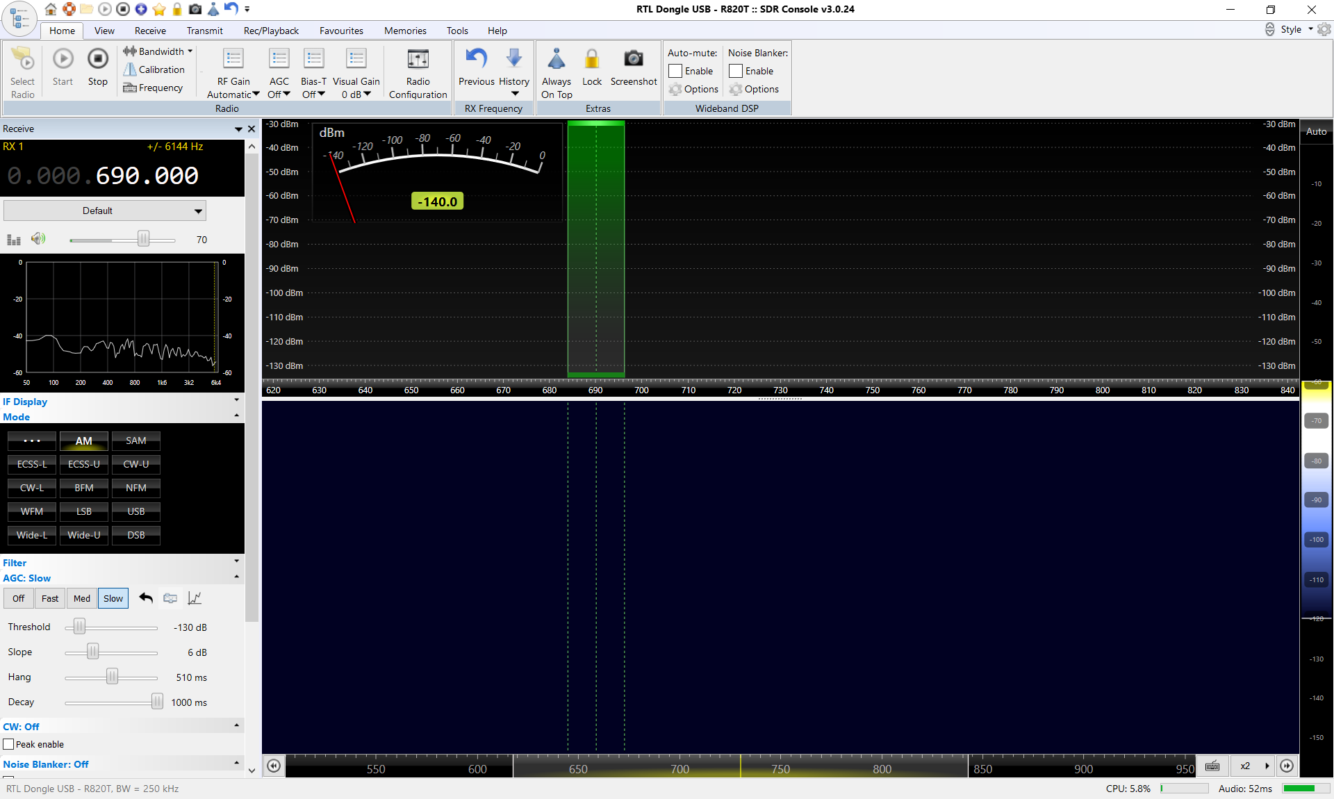

I have only noisy sound when I set it to AM 690 (CBC) or AM 730 (Vancouver Traffic) and I can not hear any vocal sound.
Do you know what is my problem?
