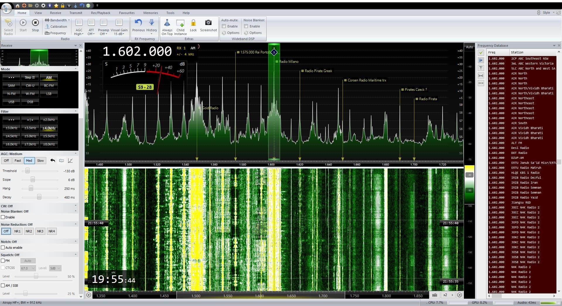

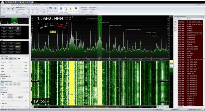

A screen shot with the DSP panel displayed would help!
But you may want to see if the DSP AGC is ON, not OFF.
The AGC can be slow, medium, or fast.... but make sure it’s ON and not OFF.
See “Audio Question” on this forum down below,I have a screen shot of what to look for. I’m on an IPad, and away from home where the original image is stored.
Haven’t figured out how to direct you to the exact message, no numbering system on this forum.

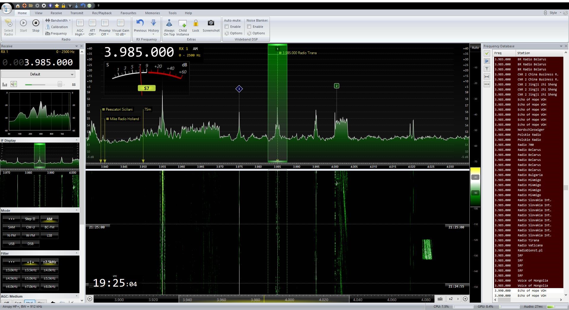

What's NOT showing in your screen shot are the NR NB settings. Close the IF display in the DSP panel to allow all the other filters to be seen and take another screen shot and post it.
If you are monitoring AM signals, you will need to open your audio bandwidth in the DSP panel more than +/-2.5kHz. Hams are typically more than that , and HF BC stations are typically +/- 5KHz. Otherwise the audio will sound tinny due to the restricted audio passband.
