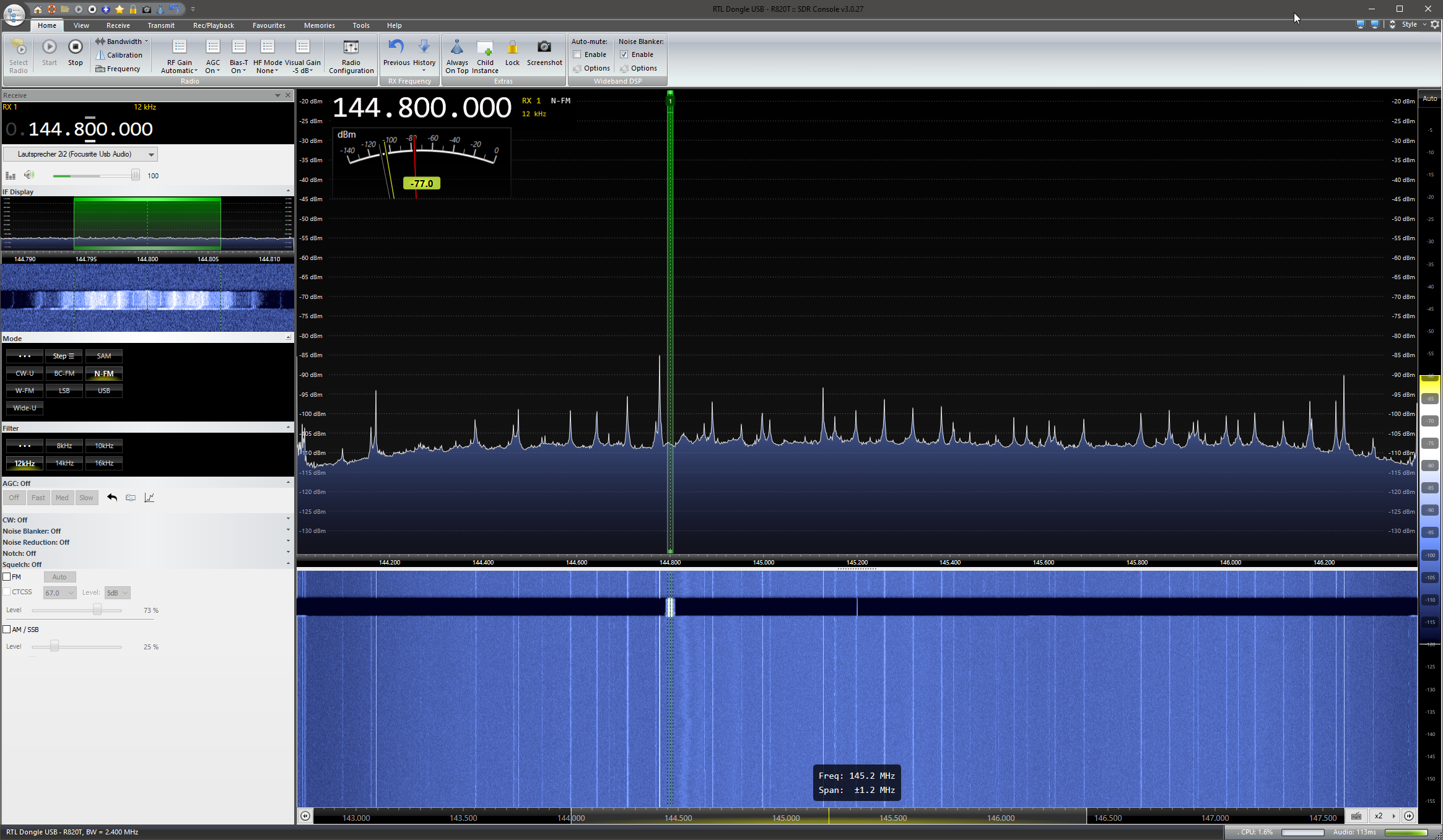

either I am too blind to check it out, or it seems that the porgram shows the wrong frequency after I dialed/switched it to "look around". I used the numbers on the left, also the black-yellowish slider at the lowest bottom.
I could not find out any threads here because i literally did not now what to look for :/

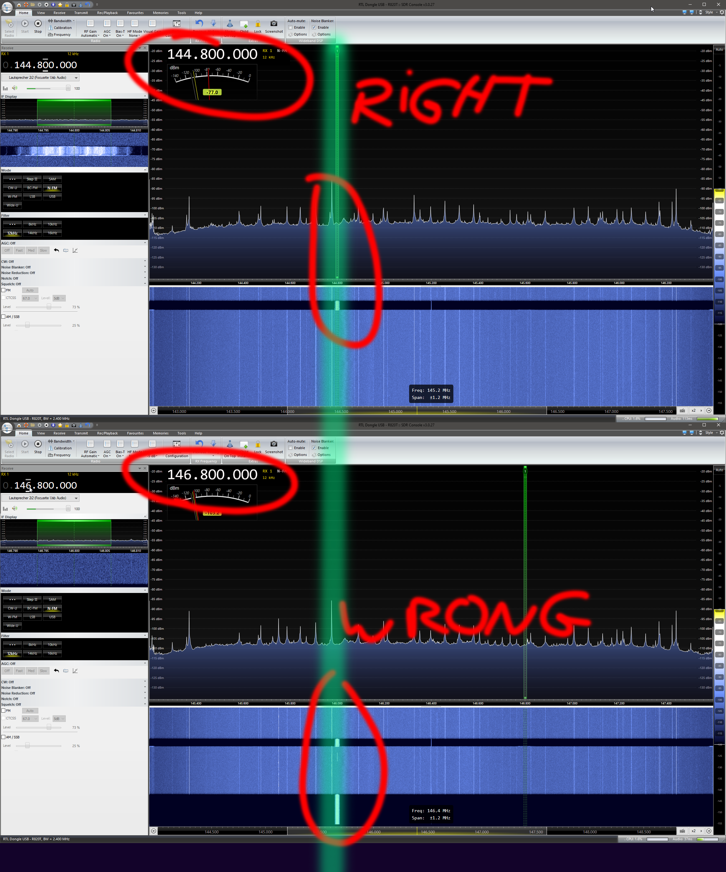

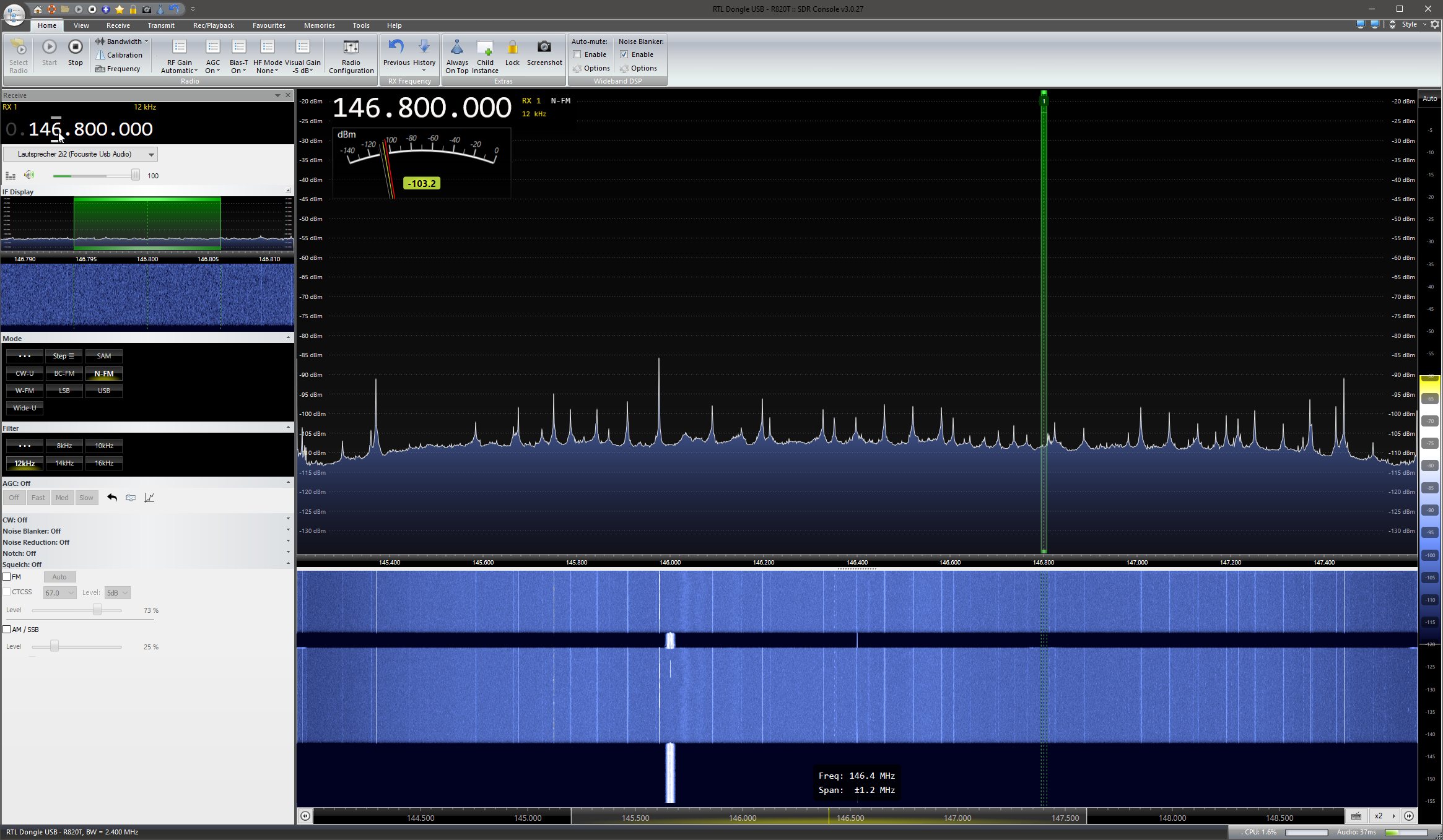

I checked it at the APRS signal @144.800 MHz which was correct at the start of the program. After I dialed around and back, the signal was on a different frequency BUT at the same position on the monitor! So I really dont know what to do to see and FIND signals on their frequency, when its wrong displayed after every change...
the screenshot shows the 146.800, but it could be any random frequency, depending on which number I dialed. here I chanced the 1MHz number obviously.

Are you saying that you hear APRS signals on the indicated frequency of 146.800? Visually, I don't see anything wrong in the first image (the one with the right and wrong notations).

Right, in the first image with 144.800 frequency, there is the APRS signal (and it should be there ;)
After tuning around, it appears at 146.800, only the position "on screen" is the same. this is why I put the green line... hard to describe, I know :?
Posts: 1025
Re: Wrong frequency shown after changing / dialing
By green line I presume you mean the wider than signal bandwidth heavily shaded top to bottom green region to the left of the spectrum, right? If you can use the built in video tool to create a 20 second or so video that shows this happening it MIGHT lead Simon right to the piece of code that is getting skipped.

I recorded a video to show my problem of frequency switching - what you can see in the screenshot above. The waterfall and spectrum does not fit to the frequency anymore afte switching to another one which is not that nice...

You changed the receiver frequency. You did not change the front end frequency. I bet the receiver muted. If you look at the bottom frequency bar that shows the front end tuning. You can slide it back and forth. That is the mode I prefer. YMMV quite significantly. People often consider me weird. {^_-}
Before suggesting a fix please allow me to suggest visiting the tools menu and the options property pages. There is a lot of stuff in there that adjusts how SDRC operates. Seeing it all even without changing anything might lead you to problem solutions quicker than help here.
Now the answer to your issue is probably in these property pages. Bring them up. On the left there is a tree view. Select "Tuning->General". Right there at the top are a pair of radio buttons. I always run with the top one ticked. But you might like the action with the lower button selected. I tend to have several receivers up at once and I don't want the front end jumping around following whomever yelled squirrel last. With only one receiver up it probably is nice to have the front end jump in frequency when the radio's tuning goes out of the front end's band.
