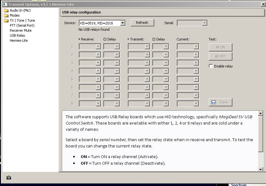

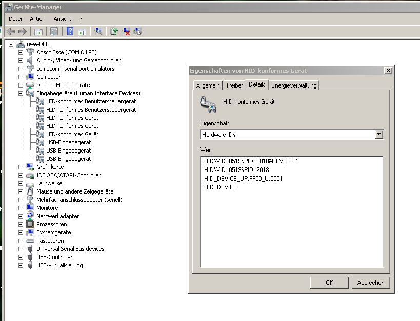

In the usb relay configuration section there are devices with VID=0519 and PID=2018.
I got an relayboard with these IDs, but it is not recognized by SDRC.
The relay is recognized under W7 ok.
Any Hints?

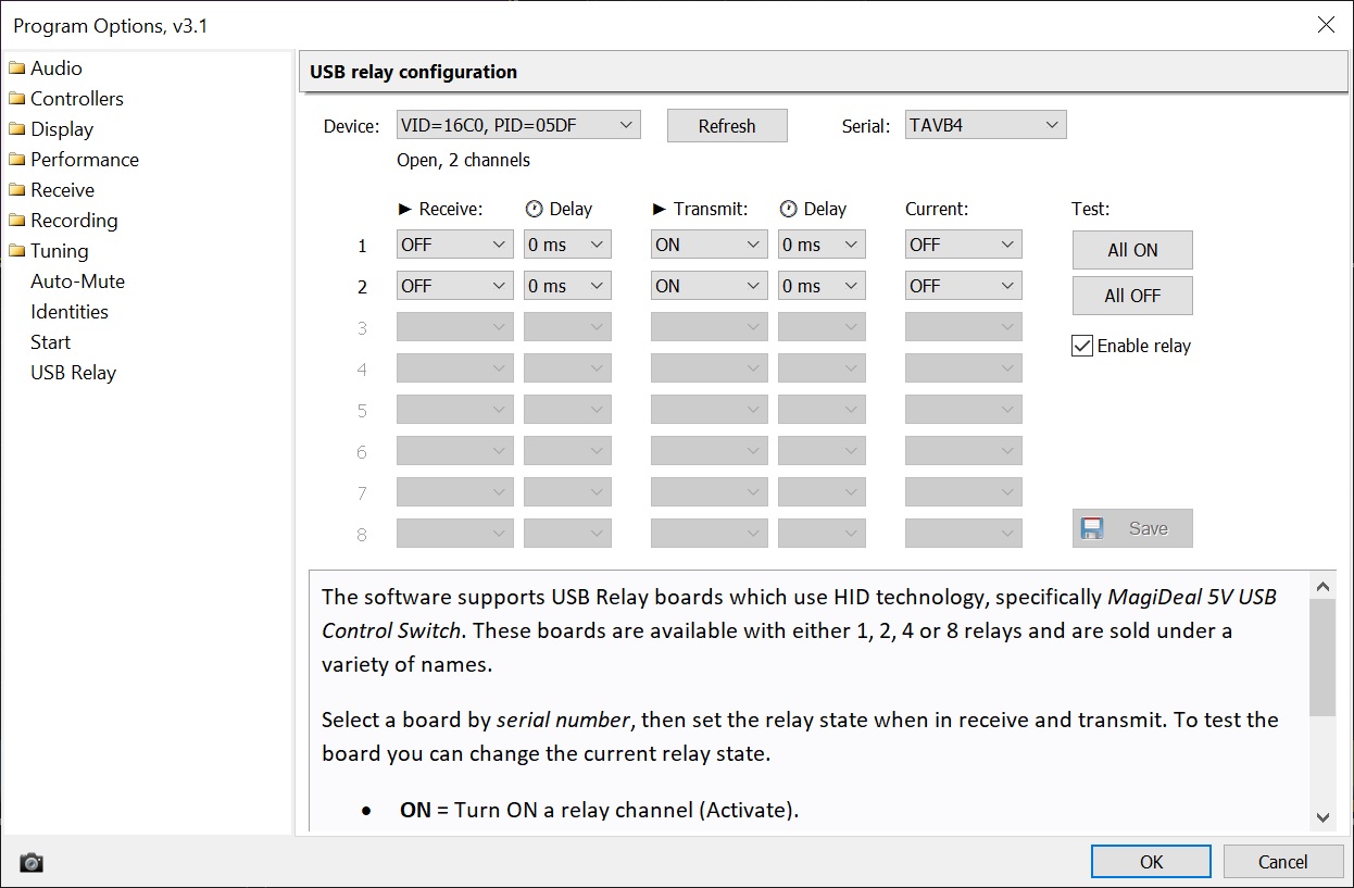

See https://www.sdr-radio.com/relays for advice.

tnx for reply.Here are the screenshots:

If you look at my link you'll see that this doesn't seem to work. I see there's a link to support code, if I have time I'll look at this as I also have one of these devices but the code has no documentation.
Update: I see how it works, may play today or tomorrow.
