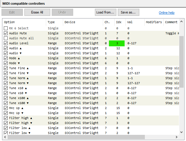

Hi, I have encountered a problem using HERCULES DJ CONTROL STARLIGHT as a MIDI controller. (DJ Control
The volume control is not linear but works in jerks, going from level 0 to 65 or 100 with a few mm of rotation on the command, it also happens by configuring the others console command for AF gain control.
Version in use: V3.1 BETA (b2365)
MIDI Control configuration

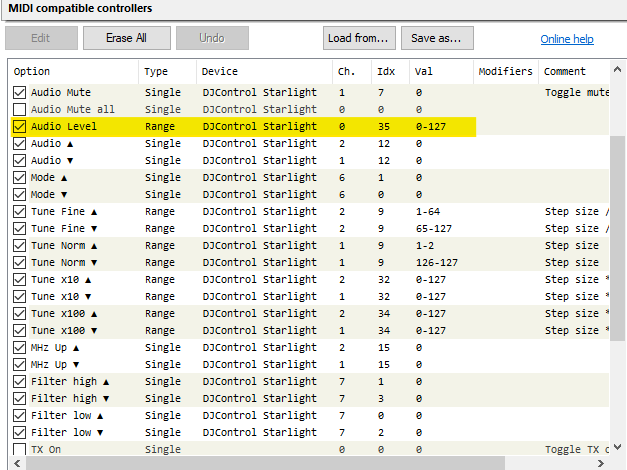

Issue solved changing the INDEX value in to XML Midi configuration file :P :P :P
</MidiDefn><MidiDefn Enable="1" Item="8" Type="3" Channel="0" Index="3" Value="0" ValueMax="127" Device="DJControl Starlight" Name="Audio Level" Modifiers="">
Here the image of setup:

Now works 100%
73 IU4FIR
