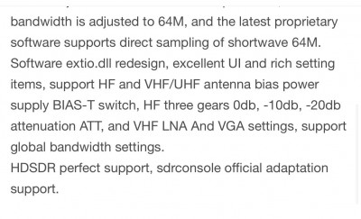

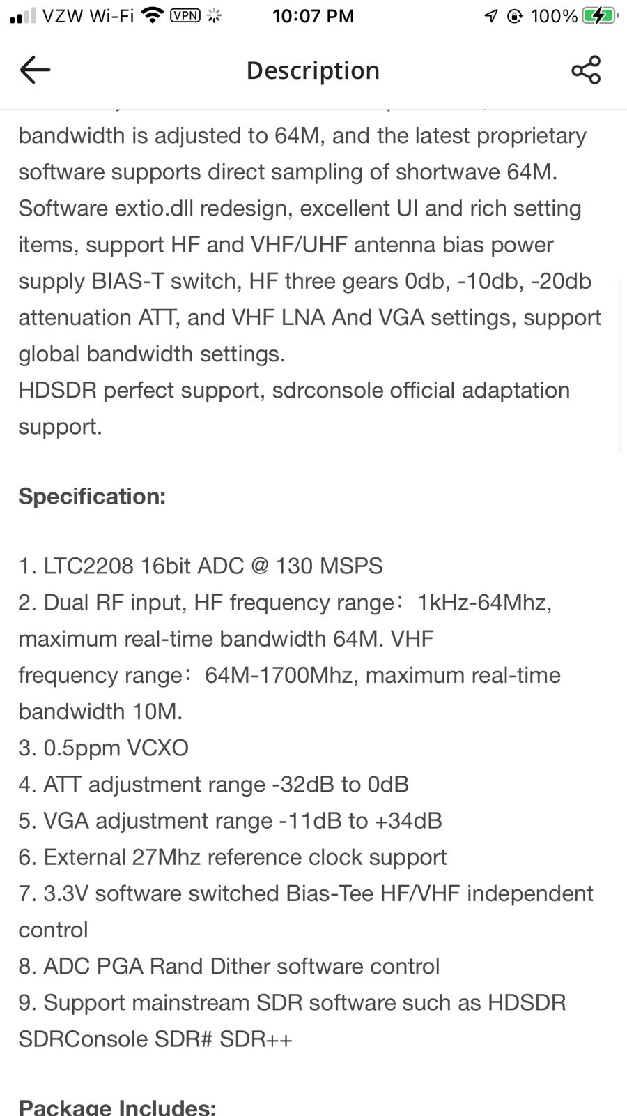

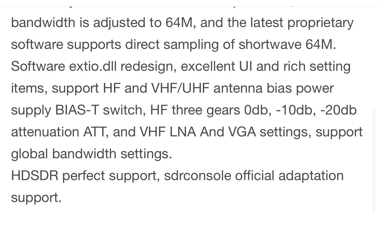

Greetings All,
I was just reading the marketing poop on an RX888Mk2 I recently purchased,
and it mentions a Bias-T included, programmable it would seem.
I include the marketing info.
Can anyone confirm the presence/absence of Bias-T facility ?
Paul
N8CVW
d93fcba133d5825f512045fe926c8d63eccf2cd33396046a5030a44b43ac380e.jpg.pdf
(164.08 KiB) Downloaded 362 times
Posts: 1049
Re: RX888Mk2 has Bias-T hardware ??!?
It has bias-t connections on both HF and VHF. I really should get my butt in gear to fake my rtlsdr.dll driver for SDRC into something that will use the Extio-SDDC.dll driver. Then merge them into a single entity. Things keep happening here that distract me. (CuriousMarc's Apollo communications hardware videos, for example.)
Simon has remarked he has little interest in fighting his way through the RX888 MKII API.
