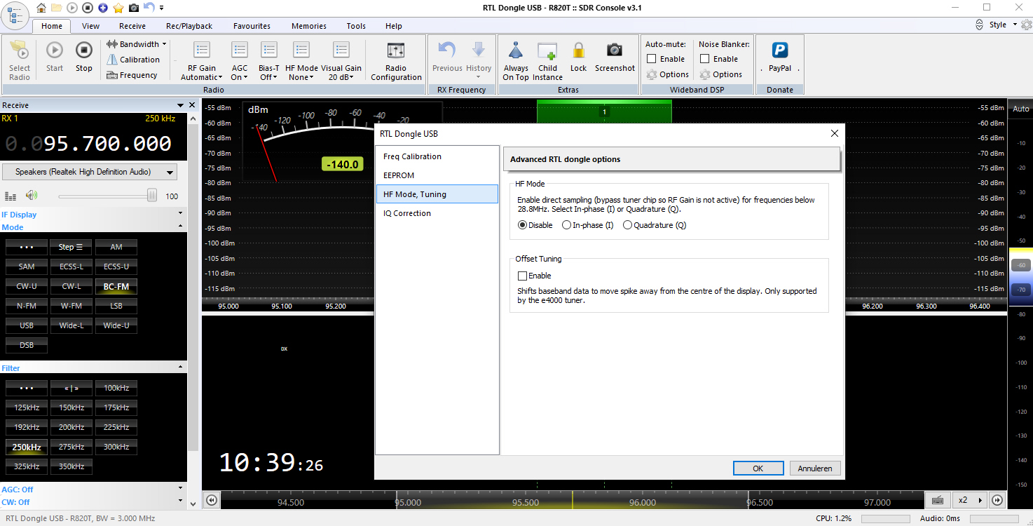

SDRplay, Pluto, Airspy, RTL-SDR 820 + E4000 are working in SDR# so RTL is using the zadig correct
SDRplay, Pluto, Airspy are working in SDRconsole
RTL-SDR did work older SDRconsole version but some mysterious way not get analyser action any more, SDRconsole hang, crashes need close SDRconsole manual.

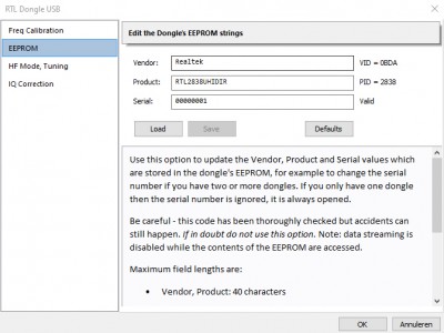

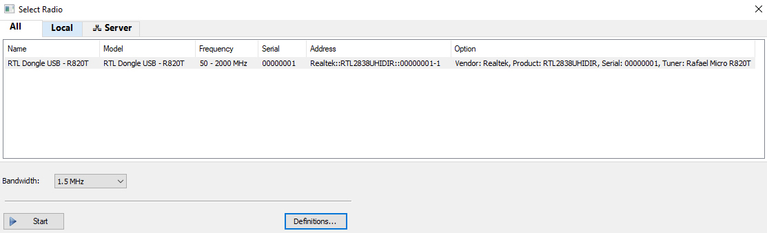

In Radio configuration RTL = detected : Realtek RTL2838UHIDIR 00000001
I try several hours, i get lost in it, any hint will help
SDRconsole RTL not working

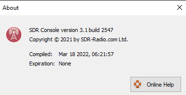

Windows 10 Home 21H1 19043.1526
The latest 3.1 download from website
SDR Console.exe 18-3-2022 - size = 25.729.792
Do i need to look in the same spectrum i mention earlyer?
Thank you for nice friendly help.
I wrote in start post : Yes, it appear in the definitionsDoes it appear in the definitions?
YesIf so and you press stop does it flip to run and still produce nothing on the spectrum?

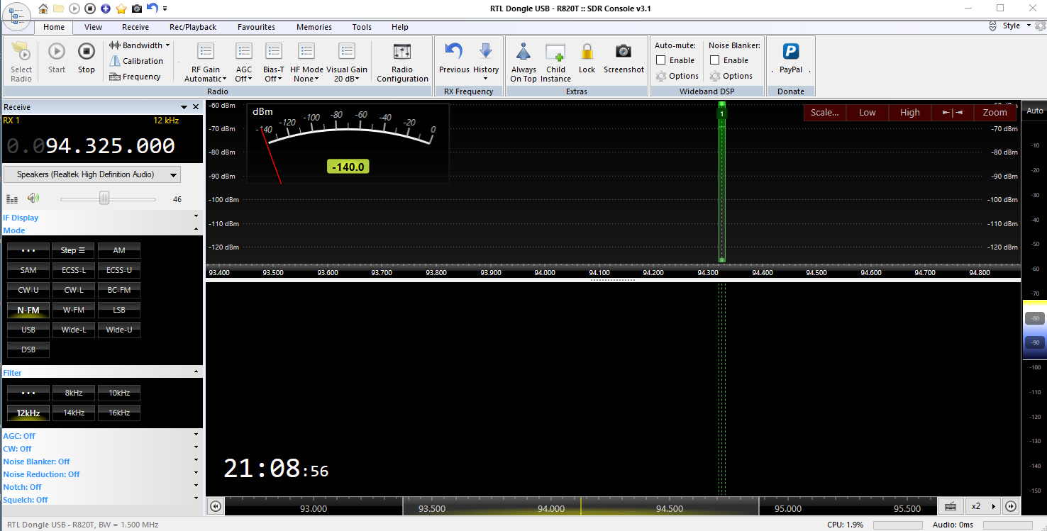

The spectrum is showing nothing. And you have the rtlsdr AGC on. And the frequency is set to an acceptable frequency. Does this dongle work with any other program? It's acting as if it's input is blown. I doubt any sound is coming out. Is that a rash assumption on my part or not?
Another possibility is that you have it setup to use frequency conversion. That could result in the dongle being pushed down to its inoperable frequency range. That should enable one of the dongle's HF modes. With nothing hooked up it might show nothing this way since the gain control is essentially gone in the direct sampling mode.
