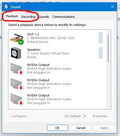

Press Start Menu (or Windows Key on the keyboard) then type "Run" (without the quotation marks). Then in the Run text box that should come up, type "mmsys.cpl" (again, no quotation marks). This should bring up the Audio Devices panel. You should see your audio devices in the list in the panel, or some at least (we hope). Firstly go to any showing and right click on it then in the dialogue box, tick "Show Disabled Devices" and also "Show Disconnected Devices". Then go through each one audio device in turn, right click on it and select "Enable". My guess from your description is that they have been set to "Disable" for some reason.
If you get this far and you now have enabled devices they should then show in the SDRC audio selection drop-down.
If you can't get even this far and get any devices Enabled, I suggest going to Device Manager, right click each audio device in turn and delete them (don't check "also remove driver for this device" or whatever the exact expression is) then reboot and Windows should find and install suitable Windows drivers for each device you deleted and hopefully also enable them in Audio Device panel. Then proceed as before (select device in SDRC drop down etc etc.

Max wrote: Wed Oct 04, 2023 9:59 pm Then go through each one audio device in turn, right click on it and select "Enable". My guess from your description is that they have been set to "Disable" for some reason.
I should have said you will need to enable all of the devices you want to use in both the Playback tab and also the Recording tab of the Audio Devices panel.

When I run mmsys.cpl, there are no devices listed "No audio devices are installed". So I deleted all the audio devices in devmgr (two headsets and vb-cable). Rebooted, devices again listed in devmgr but still nothing in mmsys.cpl.
Definitely a windows issue, I will spend some time on google to see what I can do.
