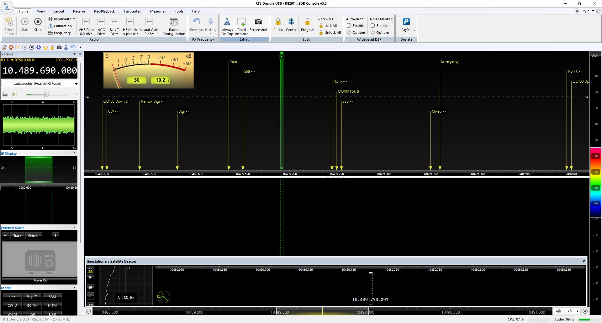

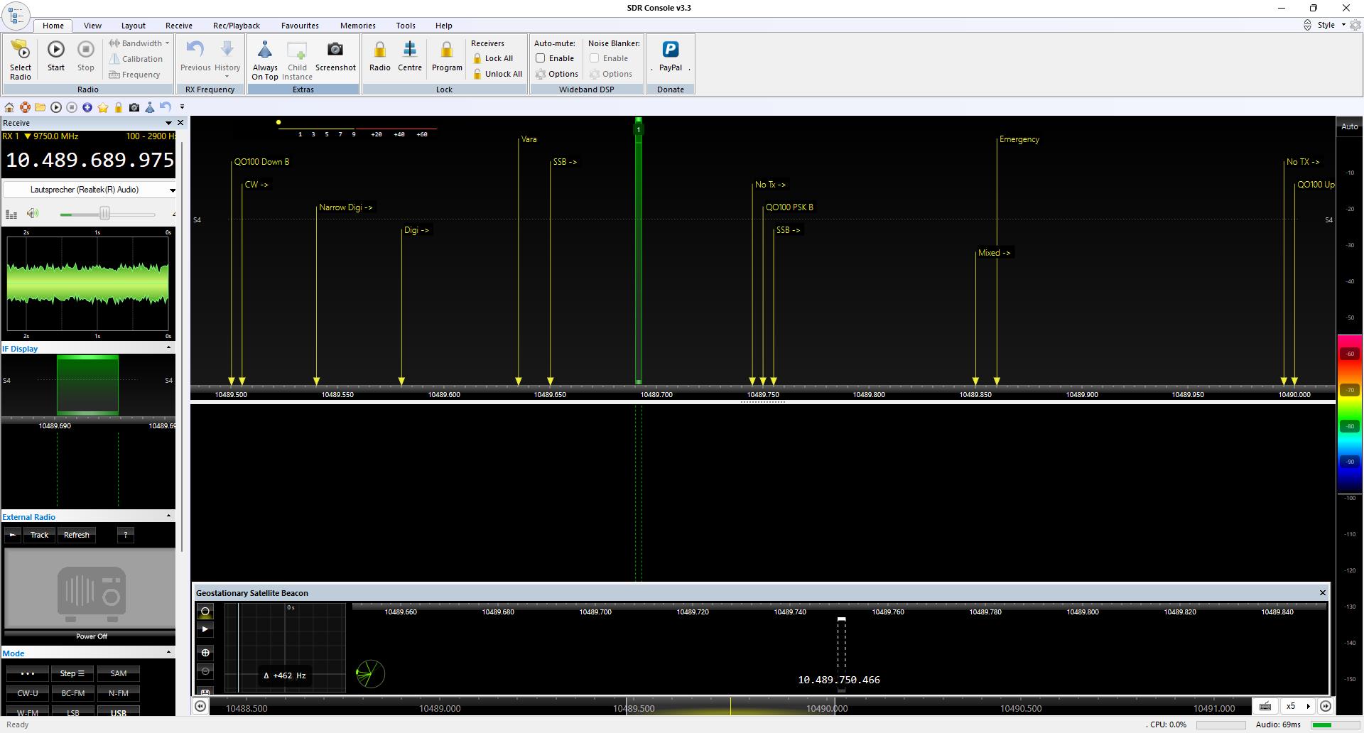

No reception was not the right description.. It seems, that the rtl receive not the right freqency but I did not change anything in the configuration of the definations of rtl dongle and after reinstallation of the older version all was ok and again no change in the definitions of the dongle..
I send 2 screenshots, one with the older version and one with the newest version.

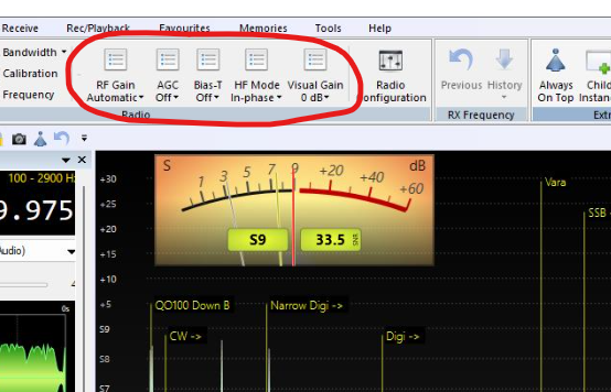

once again the newest version:

Guntram wrote: Sun Oct 15, 2023 8:51 pm No reception was not the right description.. It seems, that the rtl receive not the right freqency but I did not change anything in the configuration of the definations of rtl dongle and after reinstallation of the older version all was ok and again no change in the definitions of the dongle..
Must admit I don't see anything obvious here. However, did you try going to "Definitions". Then delete the current RTL definition, close down then re-open SDRC (this step probably not necessary, but just in case) the re-add the RTL Radio Definition? I can't help feeling it's something to do with the new RTL DLL that has been added in the new Beta version? May be necessary to "re-sense" the dongle.
Also, what make is the dongle? Is it generic dongle or is it RTL-SDR Blog V3 or similar?

For your issue, can I suggest that in the Radio Configuration panel, you change "HF Mode" to NONE (or whatever is the top drop-down option) instead of "In Phase".
Also that in the same panel, you turn AGC to ON.
Try one or both of those options and see what happens?

So, all is functional again, also the newest version!
The problem was, that the new version set the VHF Gain in the radio panel to 0db. Automatic did it and this was the reason, that I heard some modulation wide in the background.
