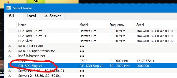

I'm talking about local mode. Possibly the attached image will help.
