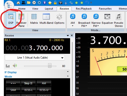

Bob, I suspect you are talking about the need for the RX DSP panel at least and if you intend to TX then the TX DSP panel also.
Activate here:

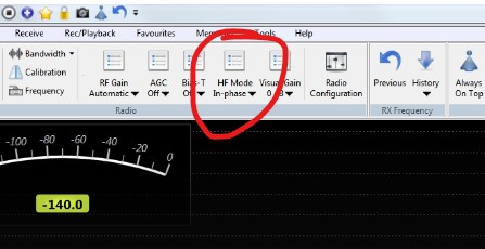

Max, I'm getting somewhere but I can't get AM OTA broadcast to play anything? Does this look right?

steelgtr wrote: Wed Jan 31, 2024 1:22 am Max, I'm getting somewhere but I can't get AM OTA broadcast to play anything? Does this look right?
Depending on model or RTL-SDR Dongle you may need to try switching to Q-Branch. See below. Also try with IF AGC on.
AM reception at 810kHz on RTL-SDR dongle is often very poor on many dongles. Try higher up first, SW broadcast bands around 7MHz.
Also maybe try some broadcast FM first in which case you would need to switch HF Mode off (for frequencies above about 22MHz). For FM broadcast the correct mode is BC-FM, not WFM.
I also suggest you run the latest Beta of SDRC as it has the latest DLL files for RTL dongles, more particularly it has the correct DLL for the RTL-SDR Blog V4. Without this the V4 would not function correctly.
Particularly if you have a Blog V4 dongle, you will need to download and install SDRC 3.3 (Beta). There is no need to uninstall the old version of SDRC. Just install over the top of it. It's worth just using anyway, whatever your model of dongle. It is tested as being fully stable:
If you have a V4, delete the existing RTL Dongle from the Radio Definitions, then re-add it and it will be correctly recognised and add the correct features.
