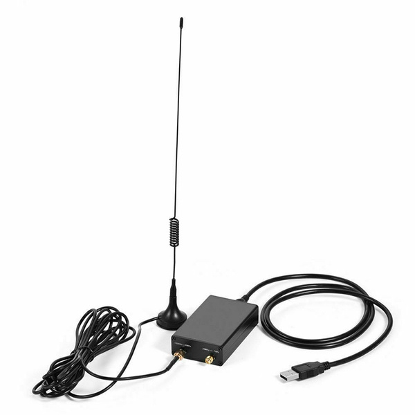

oh sorry about my mistake
my device is:
100KHz-1.7GHz RTL-S DR Full Band Radio USB Tuner Receiver RTL2832U + R820T2
I have attached its pic.

mbzadegan wrote: Thu Sep 24, 2020 8:21 pm oh sorry about my mistake
my device is:
Follow the information on this page. https://www.sdr-radio.com/rtl-dongles

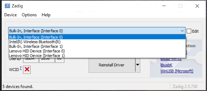

Posts: 453
Re: SDR Starter problem
Have you followed the instructions posted above by Martin M3GHE, including running Zadig, etc?

Unread post by mbzadegan »
Thanks for your help
When I run zadig, the attachment screenshot is my current status.
Does it mean my driver installed correctly?
