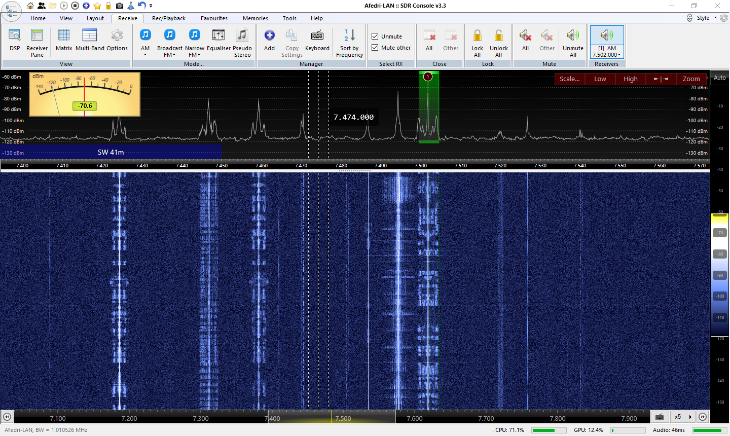

Hi. New user to SDR Console, but liking what i'm seeing thus far. That said, i've run into a very odd behavior using SDR Console 3.3 on a Windows 10 laptop with my Afedri-LAN (connected via ethernet). For the life of me, I cannot get intelligible audio from any SW broadcast stations. I've selected the correct mode (AM), have set a reasonable bandwidth for the receiver, and have made sure the RF gain and the audio gain aren't blowing things out. CPU is at 60%, GPU is at 10%, and it's showing an audio latency of 35ms. The best way i can describe it is that the audio sounds like trying to listen to a USB mode voice transmission in LSB mode.
A very odd observation is that if i tune into the 10Mhz WWV/WWW signal (again in AM mode!) the 600Hz 'second' tone looks (and sounds) like it's at 300Hz on the audio waterfall display. I do have the 10Mhz carrier centered pretty well, so that's not the problem.
This is an old laptop, so it's possible something else is going on. That said, any suggestions would be appreciated!

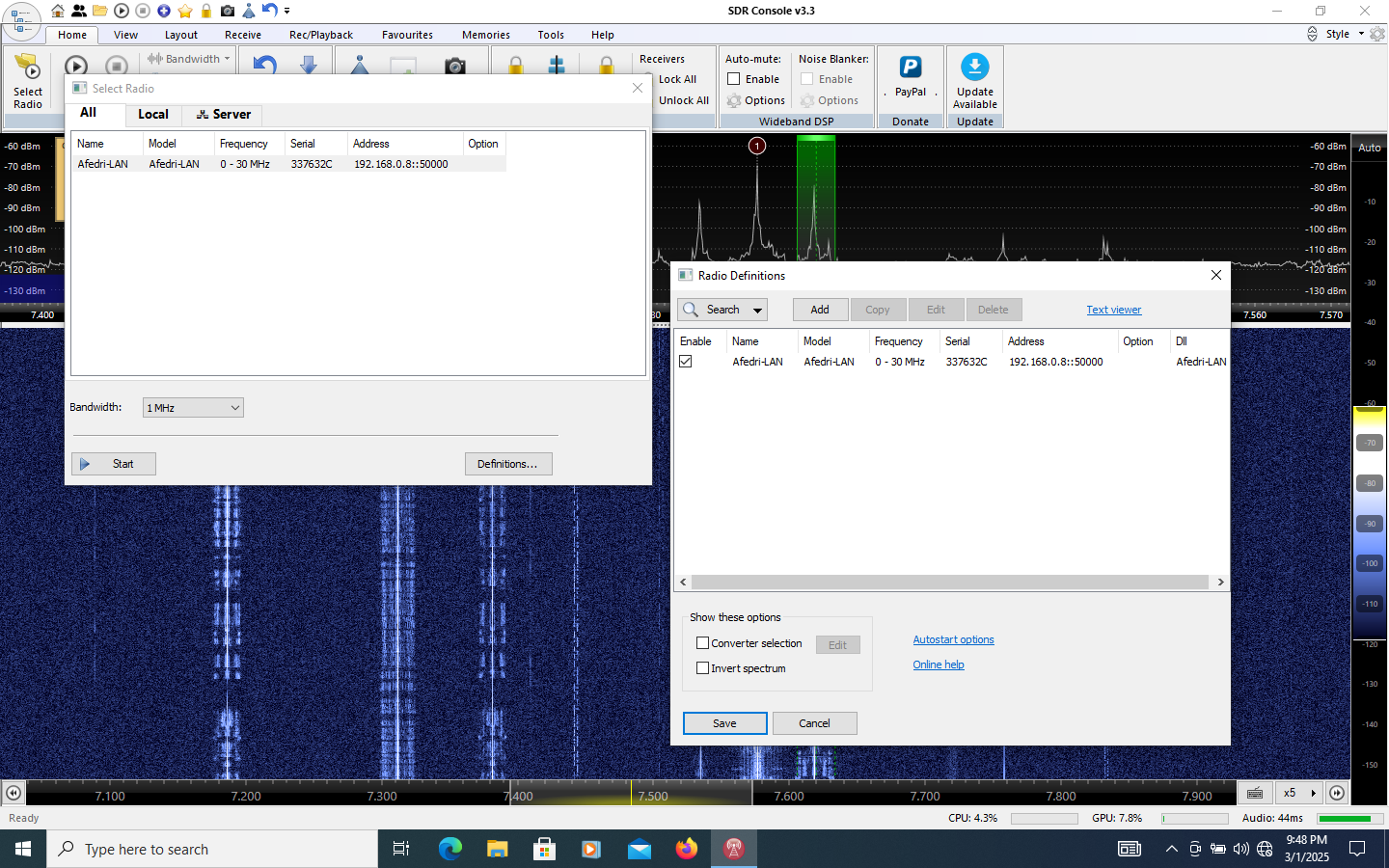

Attaching screenshots as requested...i grabbed the definitions and Afedri definition windows in one shot. Also including an audio sample of what should be a commercial AM SW broadcast...

One thing i am noticing...the Afedri definition is for an Afedri-LAN. There is a specific Afedri LAN-IQ model, but i have the SDR-Net model. Could this be a definition problem?

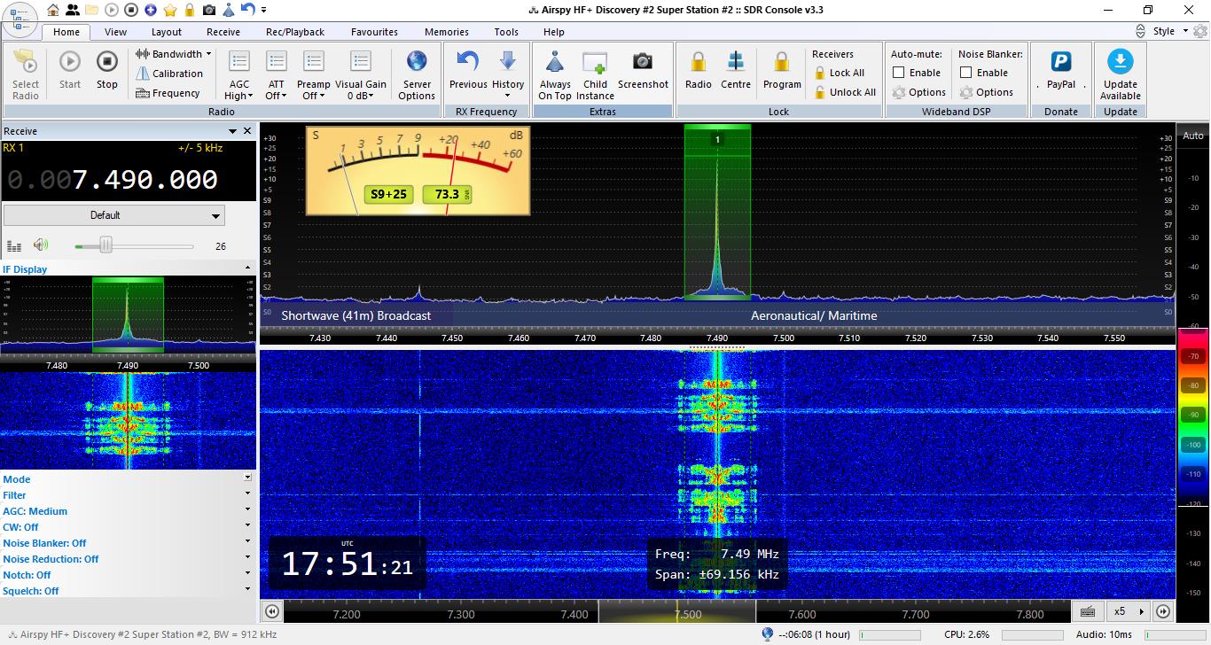

How about a screen shot with the DSP panel showing?
Something like this:
