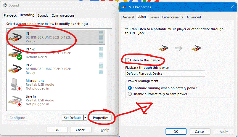

Optionally you can at the same time listen "across" that cable using Windows "Listen to this device" int he Recording tab of Windows Audio Devices:
To get to that panel in Windows, press the Windows key, then type "Run" to get to the Run dialogue then enter:
mmsys.cpl
Will bring up the Audio Devices panel.

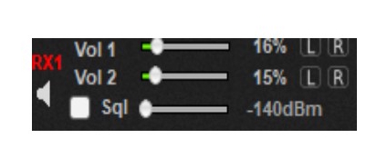

Thanks for replying. Yes, I also use the Vb-audio virtual cards. I know the listen function, but it doesn't seem very immediate. You understand that every time I have to go into the settings to enable or disable the listen function. While if I had 2 sound cards on the same receiver, I would set one to the speaker output (the default one), and the VB-Audio, used only to transfer the audio to the various software. I don't know if I can make myself understood. I'm attaching an image of another SDR software for simplification purposes only.
I was just asking to speed up audio management.
Thanks again, Michele

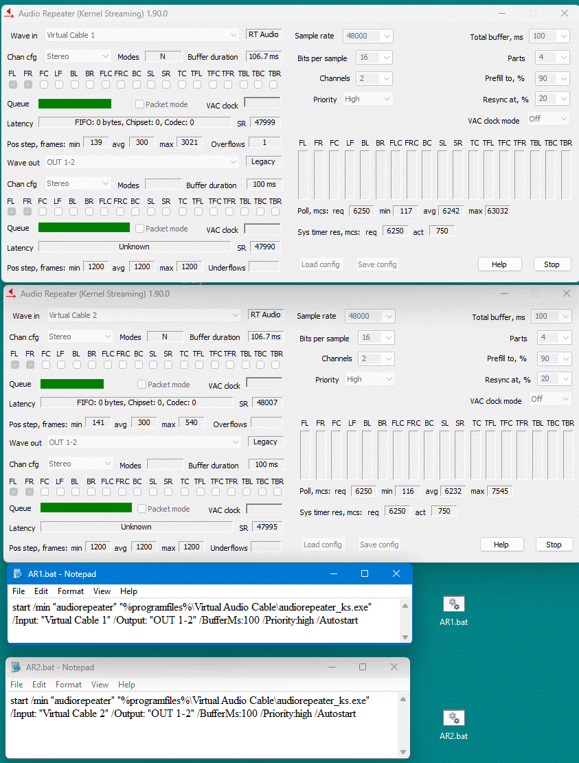

Michele, please see the attached image under this text. You will see that you can run multiple instances of Audio Repeater, one for each Virtual Cable. In my example image I have set up one for VAC1 (Audio Repeater 1 or AR1) and one for VAC2 (AR2). Each instance can be started with a named batch file which can then be left on the desktop. Click AR1.bat and you are monitoring VAC1, click AR2.bat and you are monitoring VAC2. I've also shown the text in the bat file. There are two modes for Audio Repeater. One is KS mode and one is MME mode and which version you want to use can be specified in the bat file. You need to read the documentation to see which one you would want to use. I use KS (kernel streaming) which is supposed to offer superior results. You can see that my bat file calls the KS version of the .exe file. I've also attached a copy of my .bat file for you to get you started. You need to be very specific about how you name the VAC, exactly as it appears in Windows Audio Devices of the bat file will show an error when run. This forum interface does not permit the attachment of bat files so I've re-named it to AR1.txt. To use it modify it with your source/playback names and rename the file with the .bat extension instead of .txt.
If you minimise an instance of Audio Repeater it minimises to the Windows Sys Tray. Depends what version of Windows you are running as to whether (when not minimised) multiple instances combine on the Windows taskbar or if they appear separately. If they combine anyway you can leave them all maximised and select from there.
If you want to stop monitoring one of the VACs you select that one in the Sys tray (or on the taskbar) and "quit".
I think this does what you want? Just need to be a bit cautious not to run the same bat file twice or you have two instances of listening to the same VAC but that is obvious from the unpleasant phasing sound.
Hope it helps.
