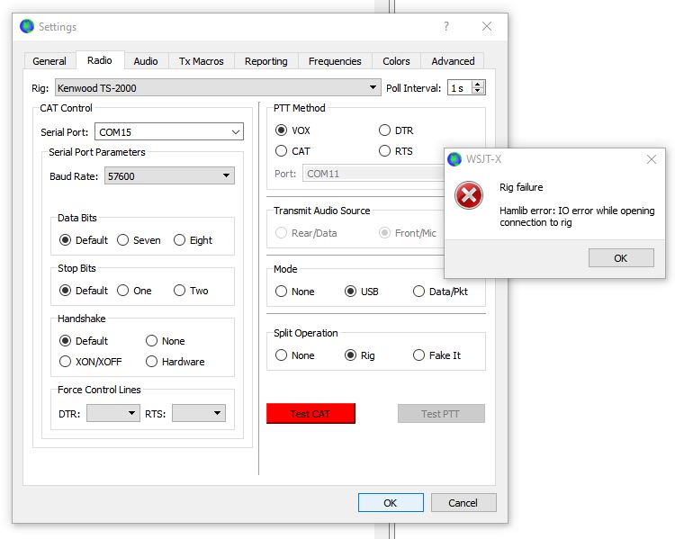

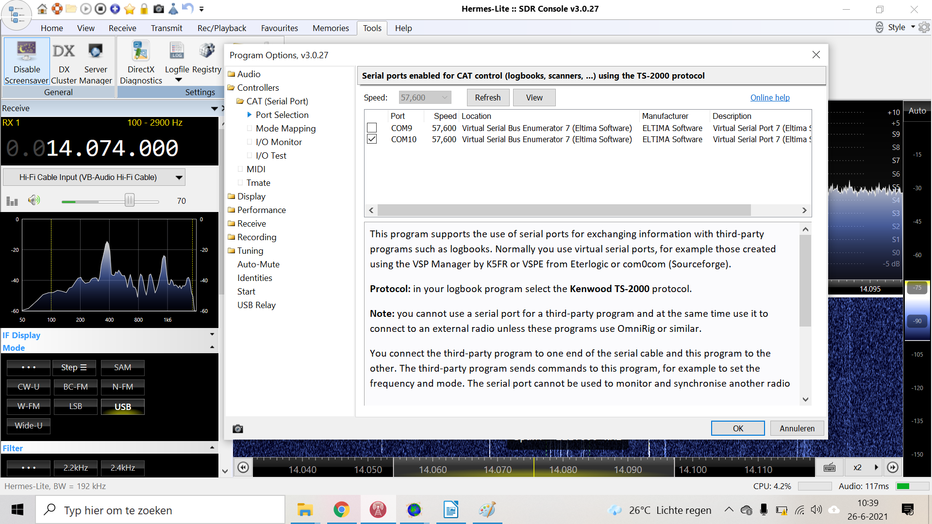

Re: FT8 on Hermes Lite 2 (or any other SDR TX)
Many thanks for replies. Becoming clearer.

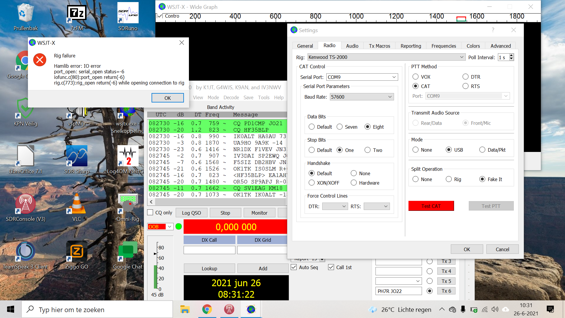

OK, so two screen grabs. One is the port settings in SDRC. The other is the Radio settings in WSJT-X which also shows the response (error message) to the "CAT test" button.

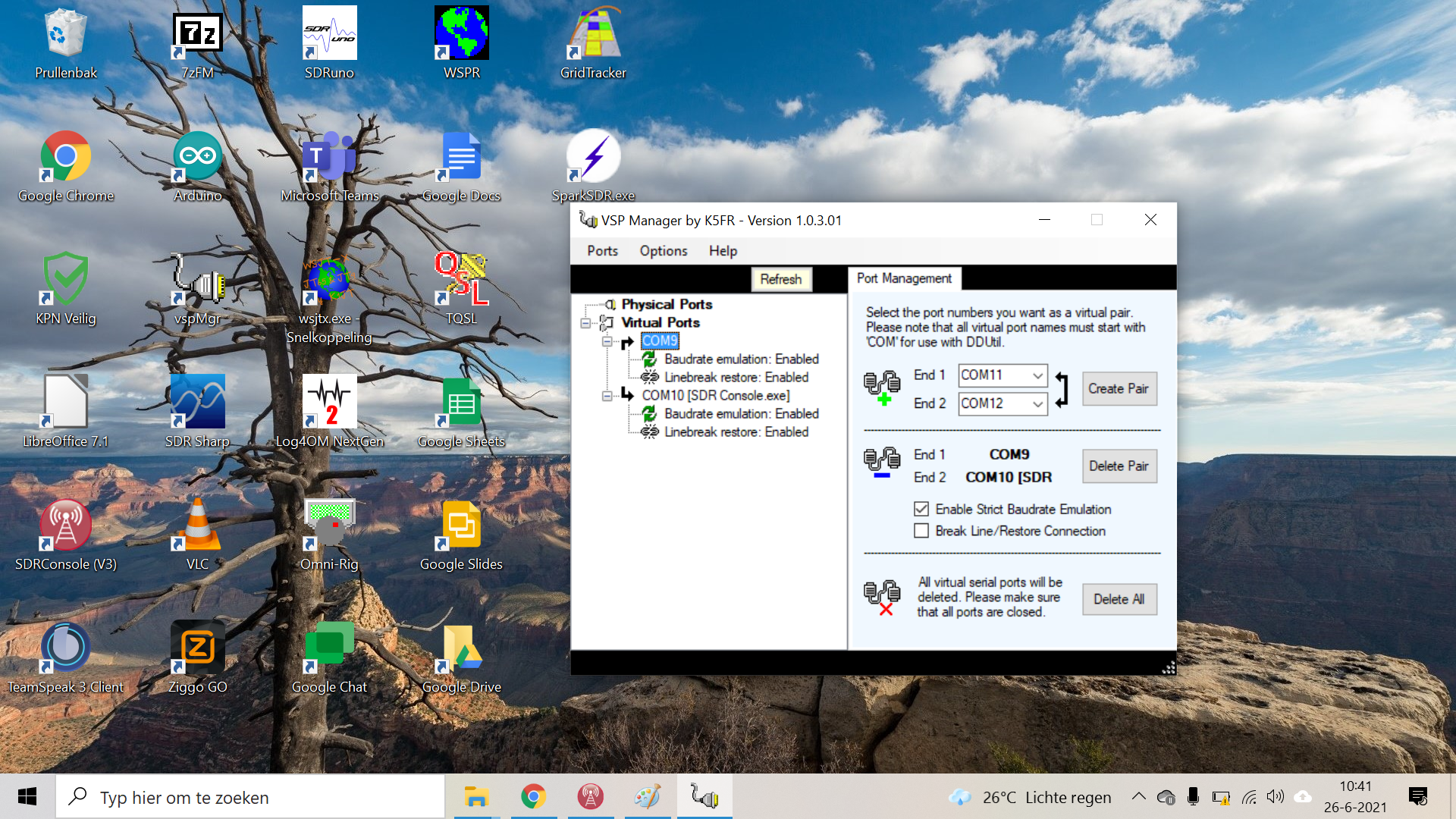

I also checked that the serial ports are present and correct in vspMgr. Looks OK.
Is there anything obviously wrong in the screen grabs that anyone can see? I've gone backwards now. Did full rest in WSJT-X, re-entered these settings and now I don't even see any control of SDRC at all, RX or otherwise. At least before it was selecting the correct frequency when I selected the band in WSJT!

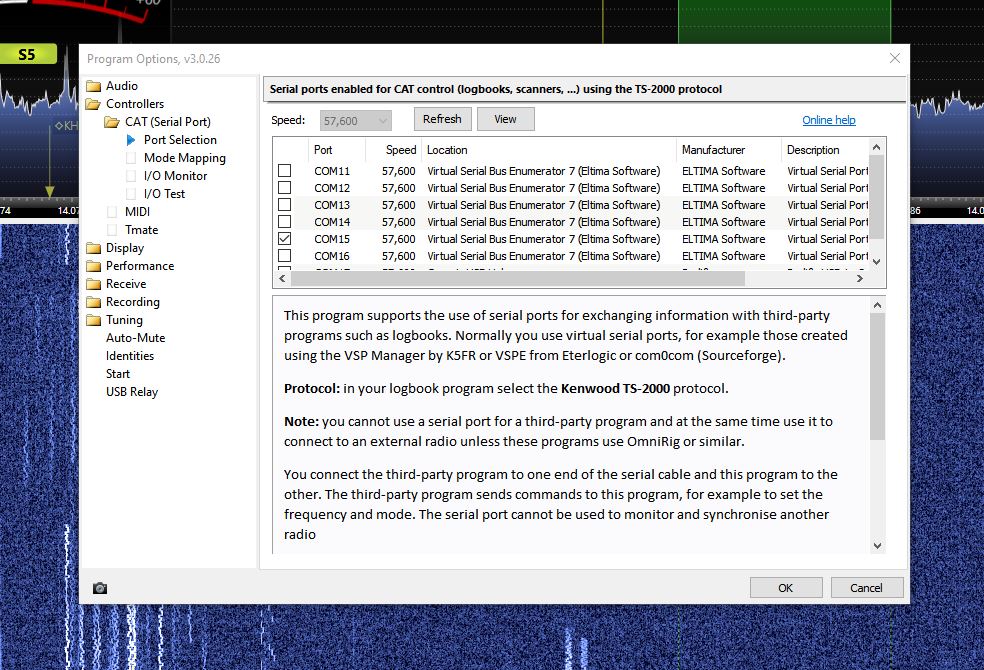

I have managed to receive FT8 messages into WSJT-X from SDRC. However when performing the CAT test is failed and with following message See below. Also in WSJT the frequency is not shown if I select it. Tried to find answers on https://www.sdr-radio.com/ but no luck yet.
Settings in SDRC

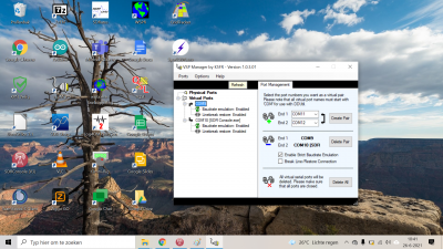

And setting with VSPmanager

So a few differences I can see between your setup and mine ( I don't necessarily understand the settings, just how they are set, and it works for me):
(1) In WSJT-X, in the "Handshake" box, mine is set to "None". Yours is set to "Default".
(2) In VSP Manager, your Com port pair has been created with the two boxes ticked, "Baudrate emulation" and "Linebreak restore" both enabled. Mine were created without the boxes ticked so they are both "Disabled". I don't remember ever changing this so it must have been how VSP Manager was set as default when I created the ports.
(3) ......and I cannot imagine why this would make any difference, but in my setup, the lower (odd) com port number is to SDRC and the upper (even) port number is the WSJT-X, so in my case, Com13 to SDRC and Com14 to WSJT-X. I only mention it so that I covered every difference between our setups.
Other than, all settings look the same all looks the same.
