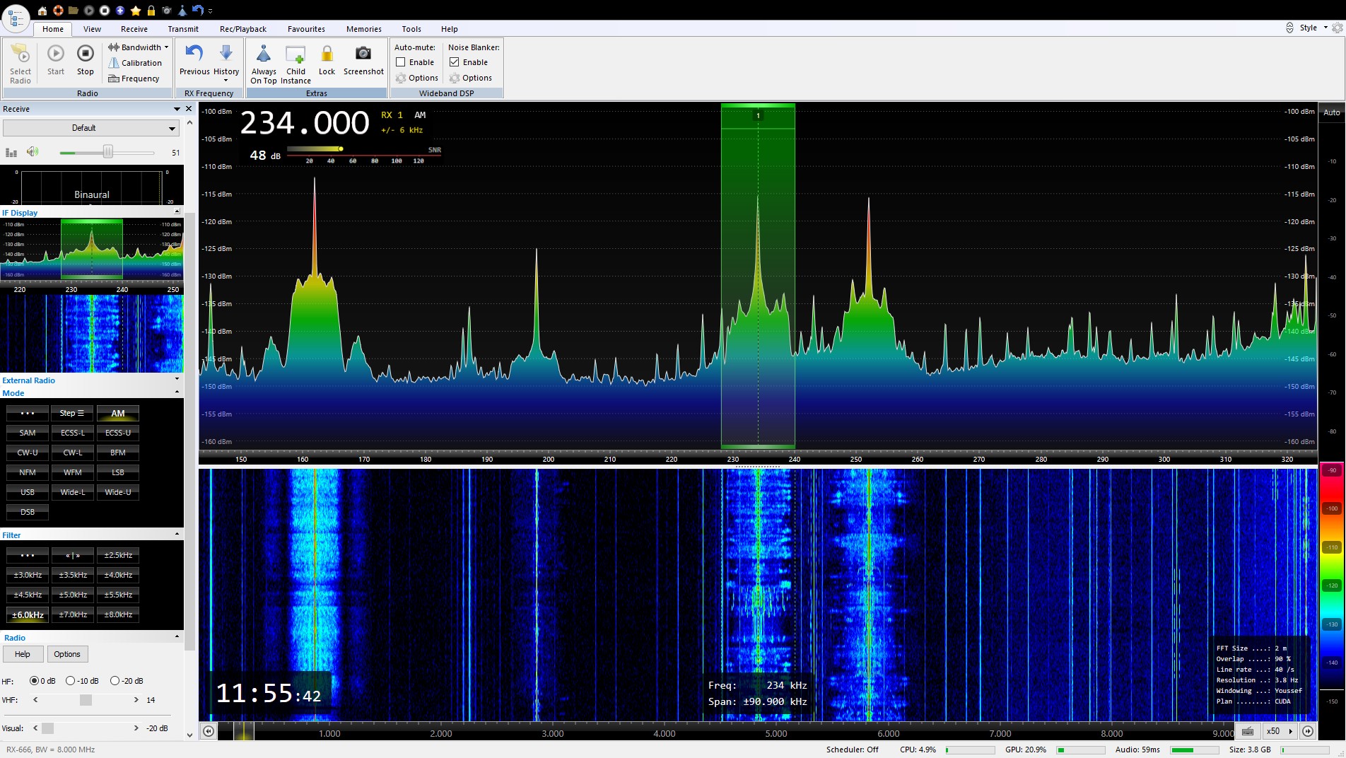

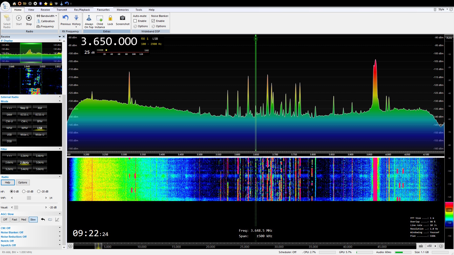

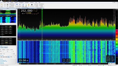

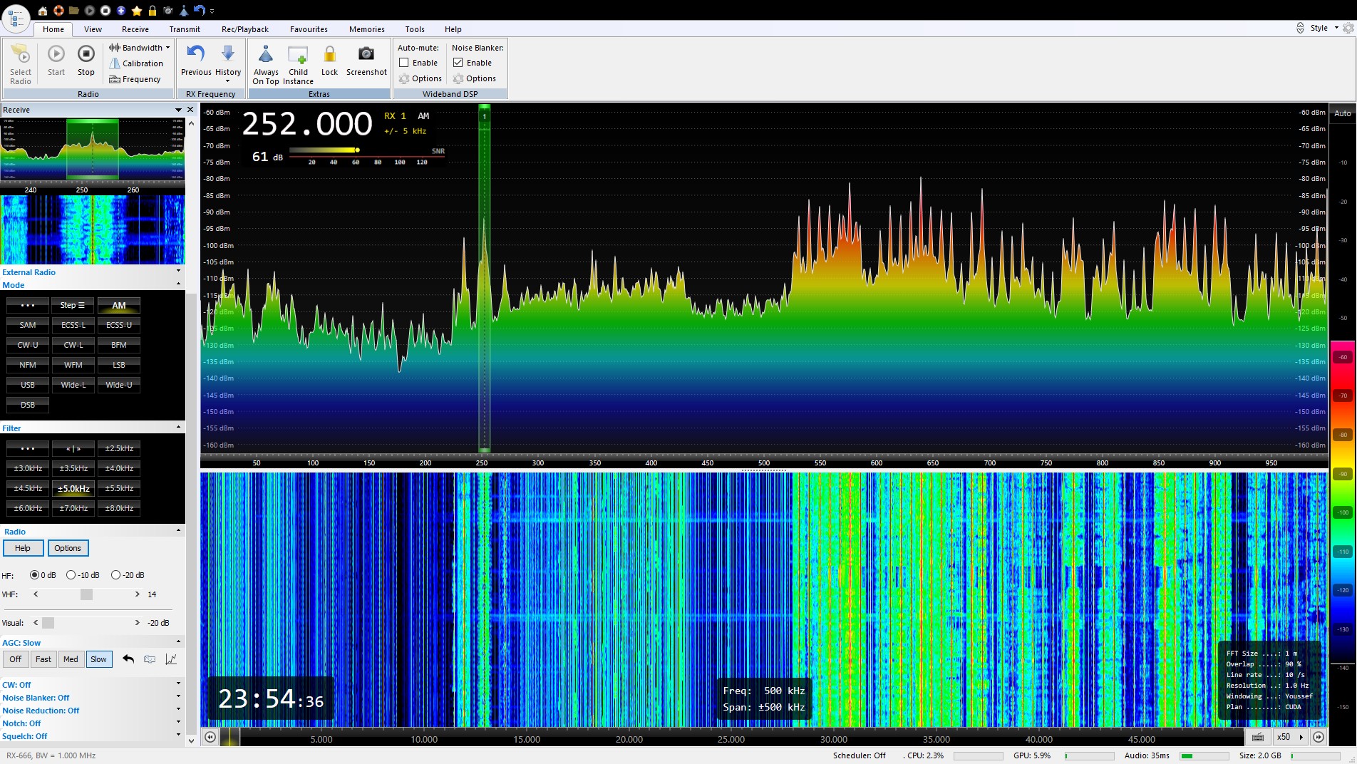

But, still due to my very good antennas, the SDR saturates, even with a setting of the Visual Gain to 20. (Same phenomenon identical and already evoked with my Airspy R One or categorically you refused to evolve the Visual Gain down)
Another point. When I settle through the View, Scale, High tab in Auto mode, there is a phenomenon of regular image hopping, not just with the RX-666, but with all the different SDRs I use. Do you have a way to reduce this phenomenon?
In addition, for information, it is frankly not useful to have a preamp on this type of SDR, yet it was planned and mounted on the model RX888.
On one of the three Screenshots provided, it is in operation with a -10 dB attenuator and this is more fun to watch.
It would be nice tore-deduct the gain again for the RX-666.

Just looking at those three graphics I cannot see what I believe to be very strong signals or instances of too much gain, so cannot totally understand your problem.
However I did note is that you have the Wideband DSP Noise Blanker Enabled in all cases. I have experienced on occasions that when I have had this blanker enabled it can cause "overload issues" if not correctly adjusted.

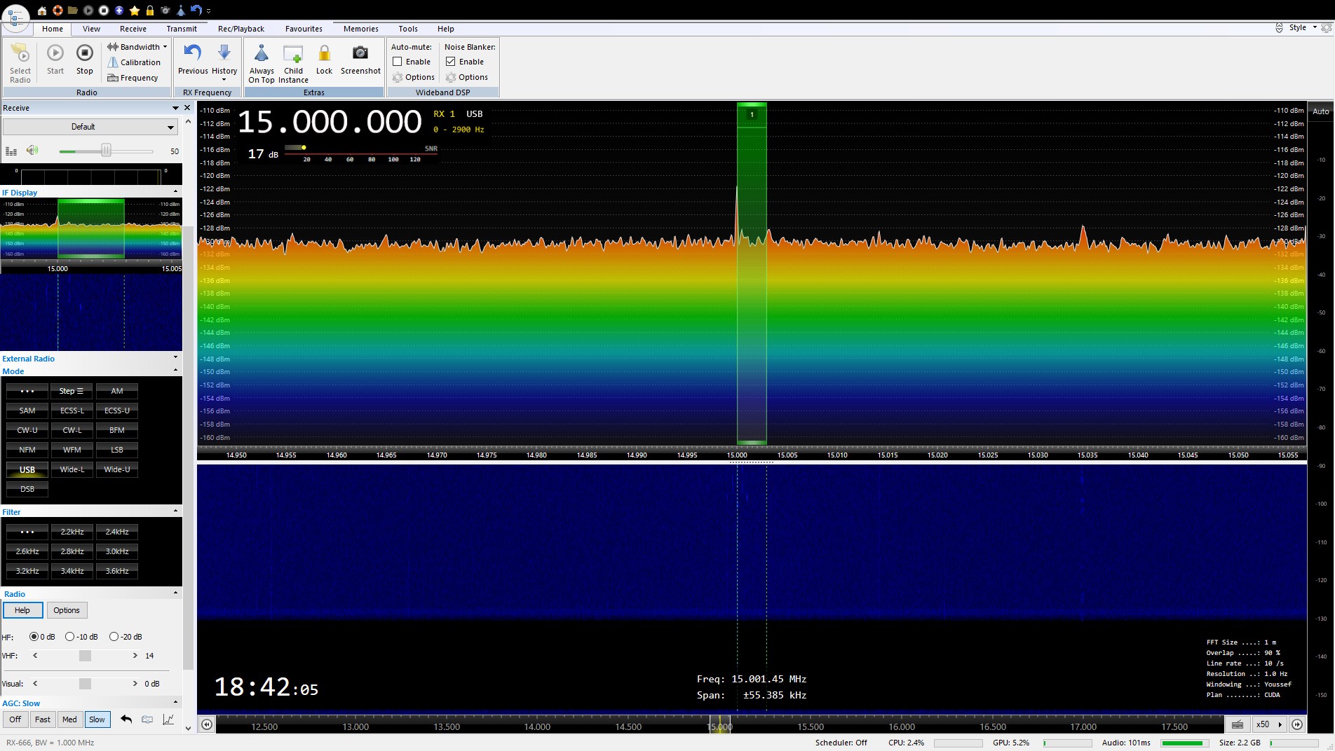

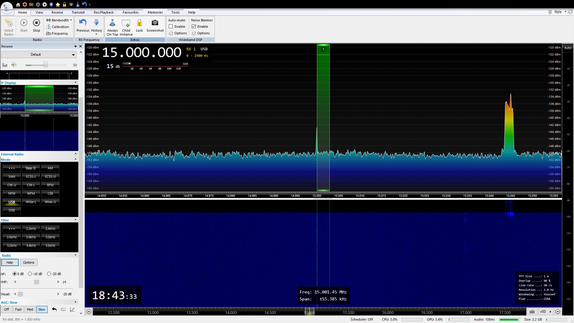

OK I have removed the DSP wideband.
But not great
Here are two screenshot
1 RX-666 to 0 from Visual Gain
2 RX-666 to -20 from Visual Gain
Re: RX-666 Too Much Gain
That is NOT too much gain! Adjust the Spectrum area high and low. The signal levels are good.
