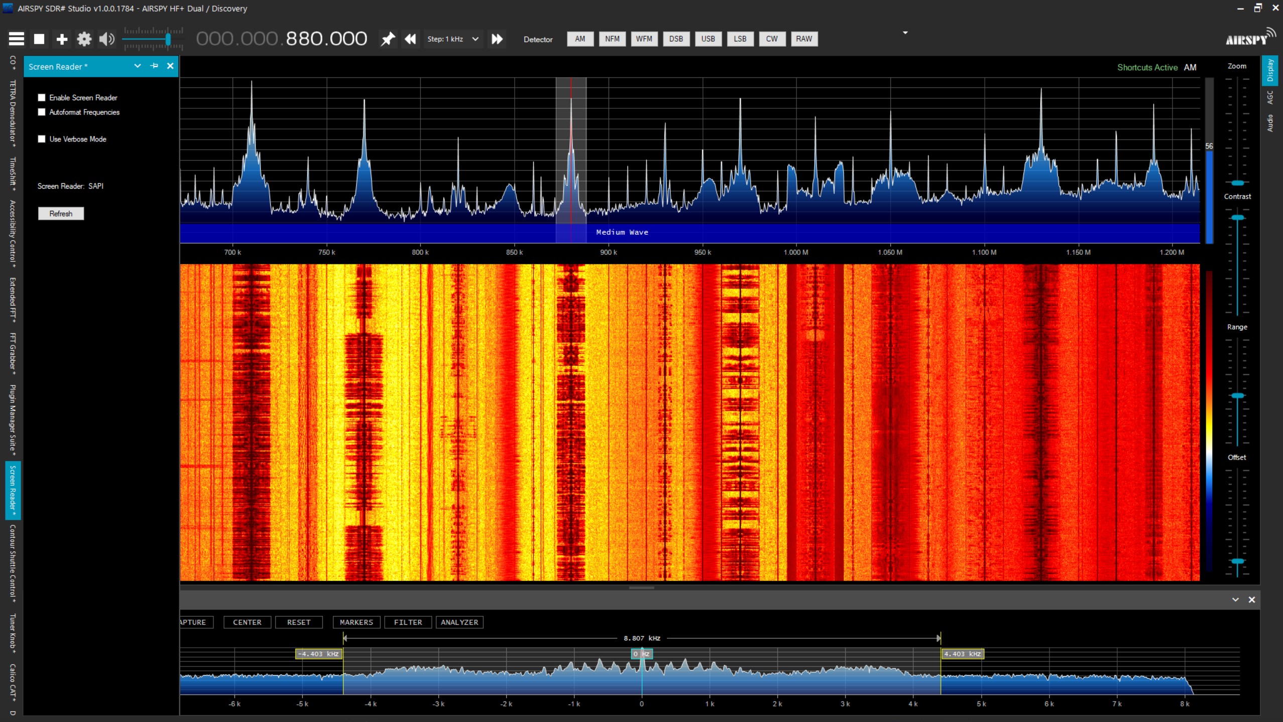

I have the latest version of SDR# running but it has an audible readout of settings - every time I change the squelch or bandwidth or volume level I get a voice announcement of the setting. I do not want this but I am totally frustrated trying to find some documentation or any clue as to how to shut it off. I have searched through the config files and can't find a setting that looks relevant. I have searched through all of the plugins looking for something that might allow me to change this setting, with no joy. Whatever I can find for documentation is not helpful. I can't be the first person to encounter this, can anyone help to find a way to shut this off?
Re: SDR#1784 how to disable audible readout of settings
And disregard, I solved the problem. The trick is to remove the screen reader key from plugins.xml The clue is, the program announces that screen reader is enabled when it first starts. But since I didn't know what screen reader was, I didn't know to disable it. I solved the problem by removing most of the keys from plugins.xml. The screen reader key seemed like a likely possibility and when I added it back in, the audio announcements started again.

Have you turned off the options in the Screen Reader tab?
