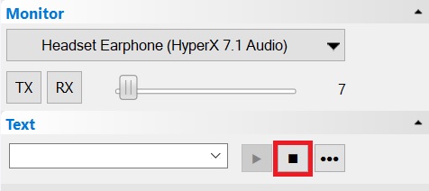

Disable the Monitor option if you do not want to hear the TX audio. If you still have problems add a screenshot.

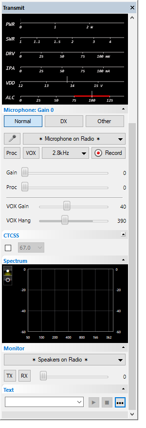

Re: Monitor during transmit (FDM-DUO)
Hi SImon,
Thank you for your help. Unfortunately, this option is inactive/grey, see the screenshot attached.
Milos
Milos

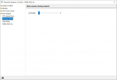

- Posts: 2166
I have just switched on the FDM DUO, will test this. Looks like a Mute option is not set (TX options).

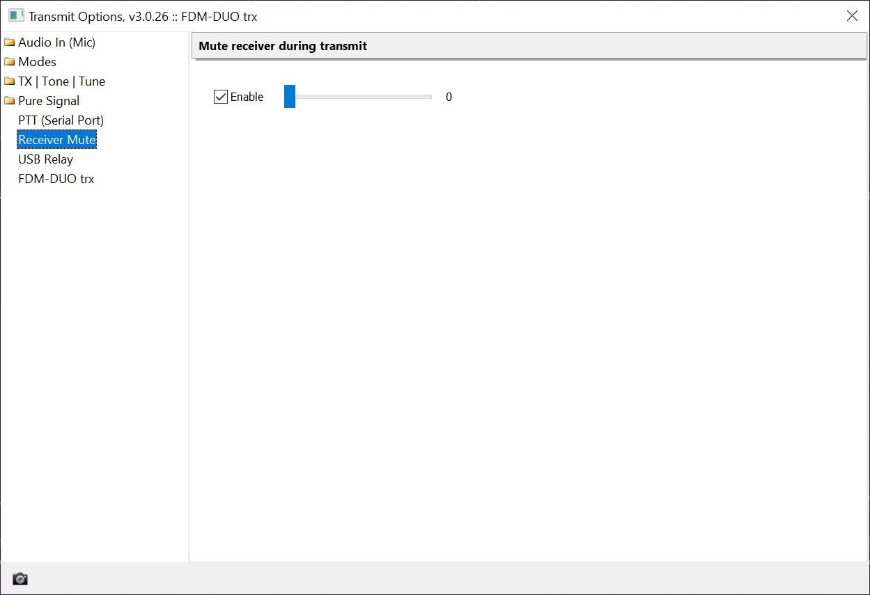

Thank you that you are still trying to help me with this. Unfortunately, the option Mute receiver during transmit was set exactly how you showed on your screenshot. Now It seems to me to be more bug than incorrect settings. But it is strange that nobody else does not complain about it.
Milos
Milos

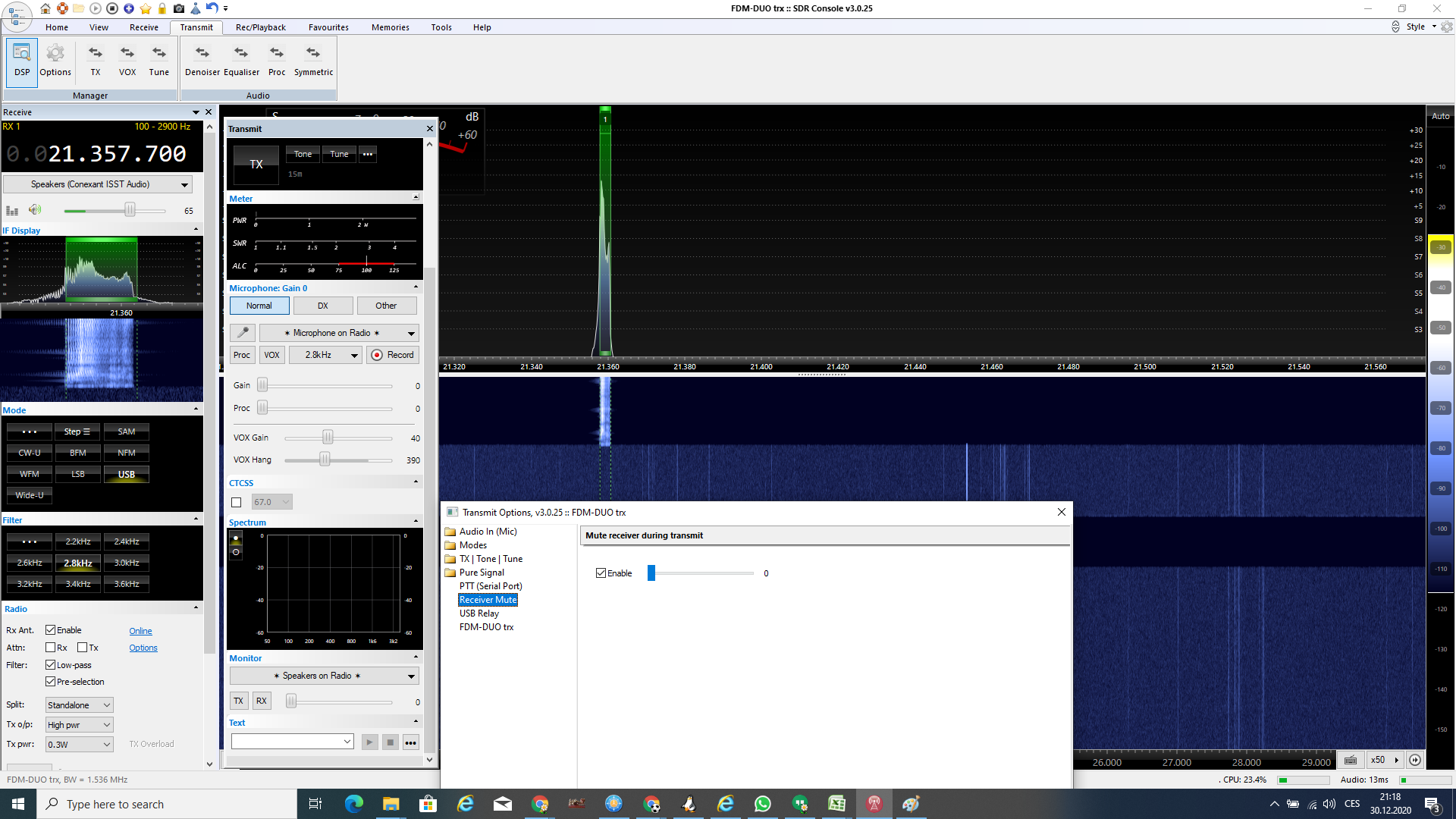

Please see my screen shot attached.
I made sure that all the three points are OK. It should be visible on the screen shot.
I also made a short video - link here:
You may hear a small "echo". This echo is a little bit delayed my audio.
Milos
Milos
