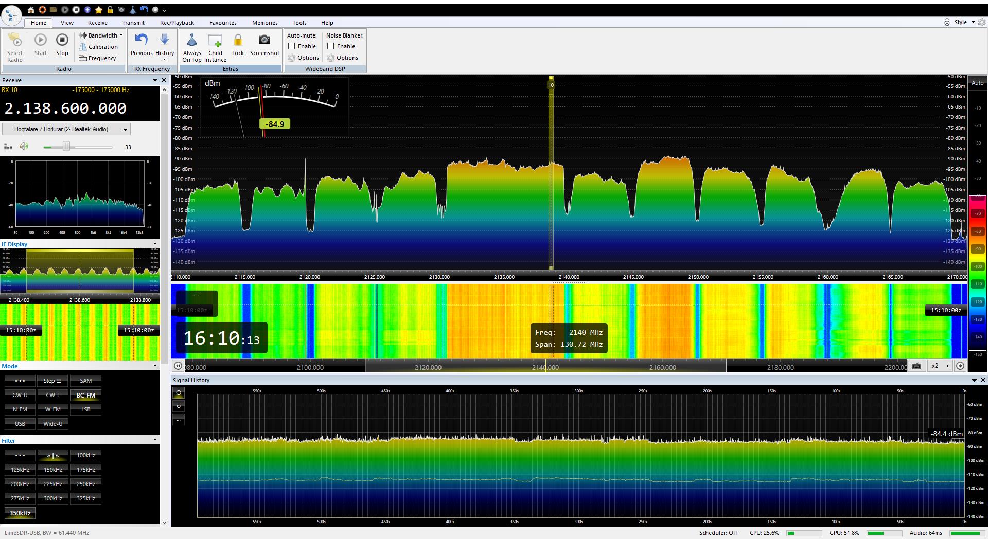

Re: Rx888 Mk II and v3.0.27
BTW Simon.
Here is how my laptop handles the LIME SDR at 61 MHz BW on the 2100 MHz band.
The Screenshot shows the cellular carriers (UMTS) from the local tower.
So I think 64 MHz instantaneous BW from the RX888 Mk II should be perfectly feasible to handle.
73 / Ingolf, SM6FHZ
73 / Ingolf, SM6FHZ

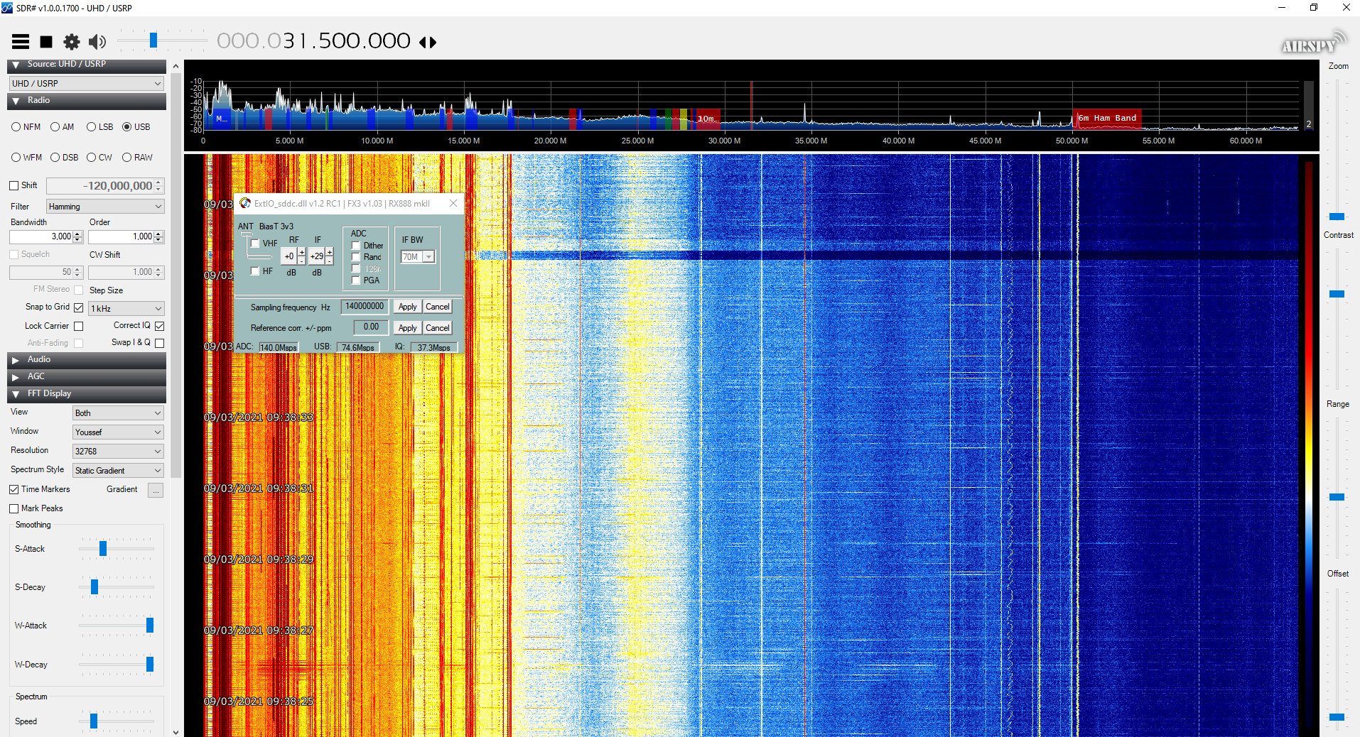

Hi, am i right that one can receive the whole 64 Mhz - with a MK2 - within SDRC but in 2 chunks of 32?
Or is 32Mhz the maximum tunable freq? 73, Leon
Leon,
The MK2 can run 70MHz via the ExtIO by editing that to 140MHz sample rate and chosing 70MHz bandwidth and all this on the HF port. I'm hoping to use it to monitor 28, 40, 50, 60 and 70MHz FT8 during the forthcoming Es season.
Sharp limited it to 63MHz viewable for some reason and on my I9 it was using about 18% CPU.
Paul
Paul
