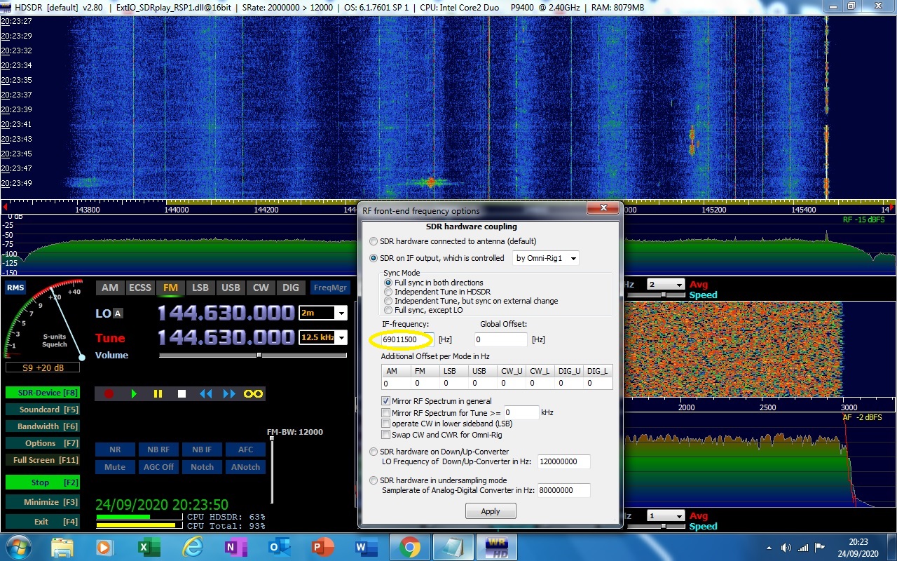

hi, I have an rsp1 sdrplay connected on the 1st IF at 69.0115mhz of the 706mk2g in panadapter mode.
With hdsdr I have the possibility to insert the IF in the front-end Rf section (see image)
the value of the IF and have the rx synchronized and with the possibility of controlling the 706.
I would like to do the same thing as hdsdr with Sdr Console, because I like it more, is it possible?

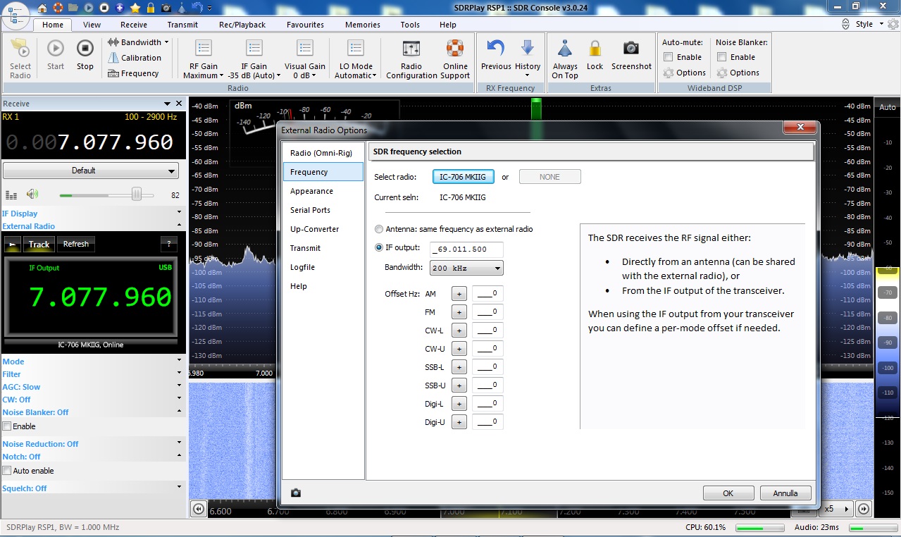

Enable external radio and set up omnirig the same as you did before. Adjust the External radio settings to suit.
Full information is here, https://www.sdr-radio.com/external-radio

Re: 706mk2g + rsp1 sdrplay + Sdr Console = It is possible?
Yes, the same way.

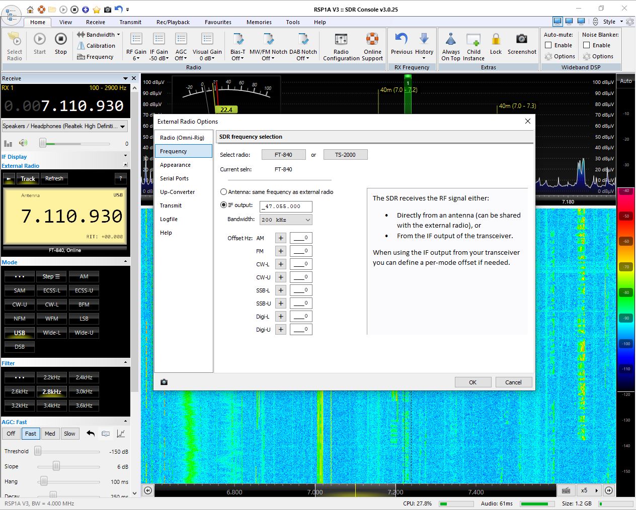

[/quote]
Hi Martin, I followed your advice and I read the guide in the link.
It worked.
Thanks for your help
Maurizio.
