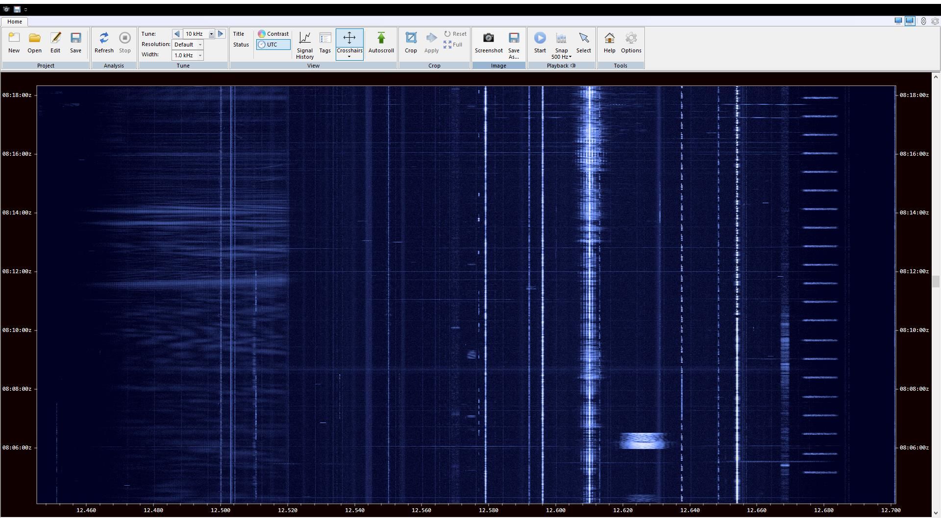

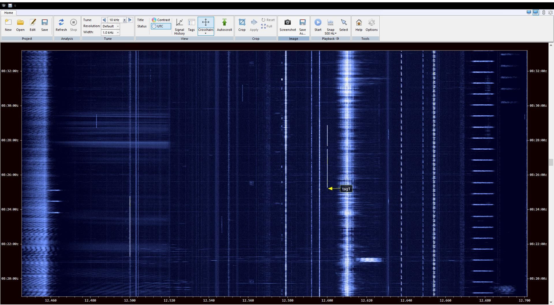

Hi Simon,
Found a possible bug using Tags in the Analyser. A video would be more convenient to show the sequence, but I'll stick to screenshots for now.
I want to place a tag in a file, see pic Tag1, at 12600 kHz 0825z.
Open Tag window, see pic Tag2, datafile jumps to time around 1244z.
One mousewheel scroll in spectrum, file jumps to around 0812z, see pic Tag3.
Correct with one mousewheel up, file jumps to around 0825z, make tag, see pic Tag4.
Close Tag window, file jumps to time around 1244z, see pic Tag5.
One mousewheel scroll in spectrum, file jumps to around 0812z, see pic Tag6 in next post (max 5 files allowed)
One mousewheel scroll up, file jumps to around 0825z, showing tag, see pic7 in next post.
73, Cornel
