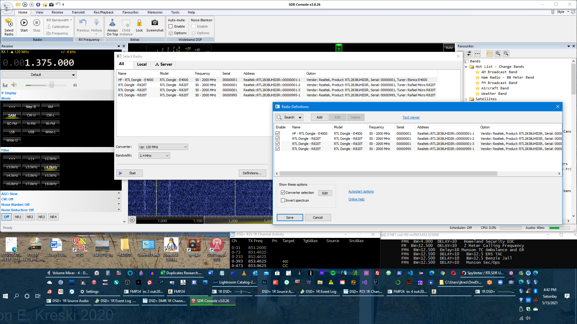

Post a screenshot of your 'Select Radio' window please.

The screen shot is attached. I run four dongles but have always selected the one dongle I designate for HF. The others were busy scanning at the time on DSD+ FastLane so it's not an issue of selecting the wrong dongle I believe.
