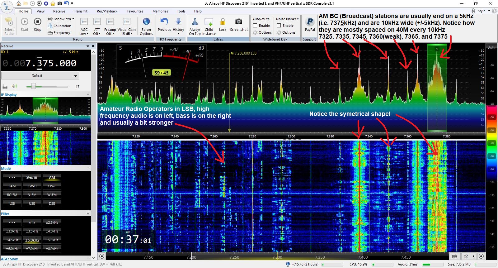

Here's a screen shot of some 40M 40 Meter Band AM BC stations thisw evening at 8:37 EDT. If you ever want to know possibly where and what the station is, just Google the frequency in kHz, i.e. "7375 kHz" and open the link with short-wave in the address... such as: https://short-wave.info/?freq=7375
You can drag and drop the green dot to your position on the globe, and the website will estimate your theoretical signal strength.
Find attached some details for ID'ing AM and LSB signals.
USB signals will be the opposite, the low audio frequencies (bass) will now be on the left and highs (treble) on the right. Once again, Amateur radio operators use LSB<10 Mhz and USB>10 MHz.
Amateur radio ops frequently operate with lots of bass to "sound good", hence the low audio frequency portion of the display is usually stronger (brighter on SDRC screen), but that's a whole 'nother topic that gets debated ad nauseam on QRZ.com's forums section! :oops:
73 Kriss KA1GJU
