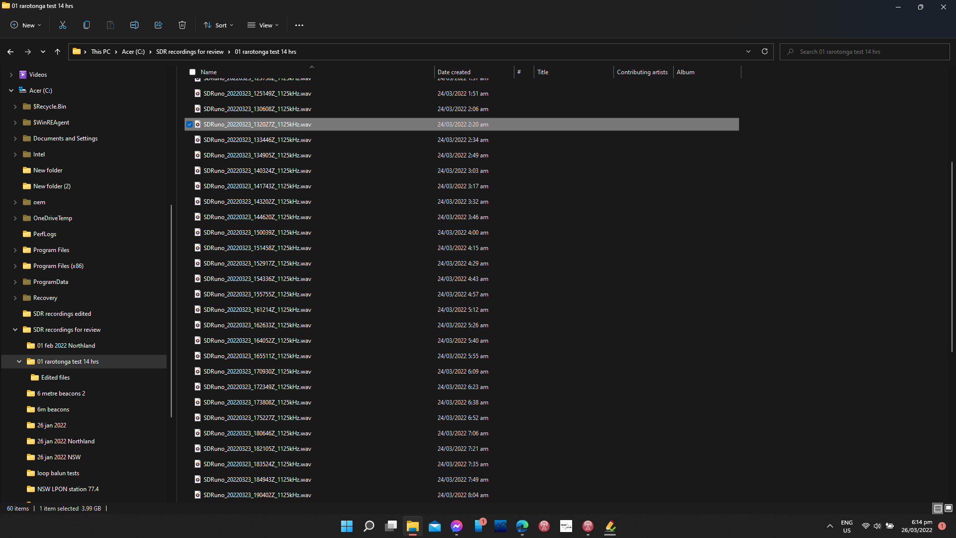

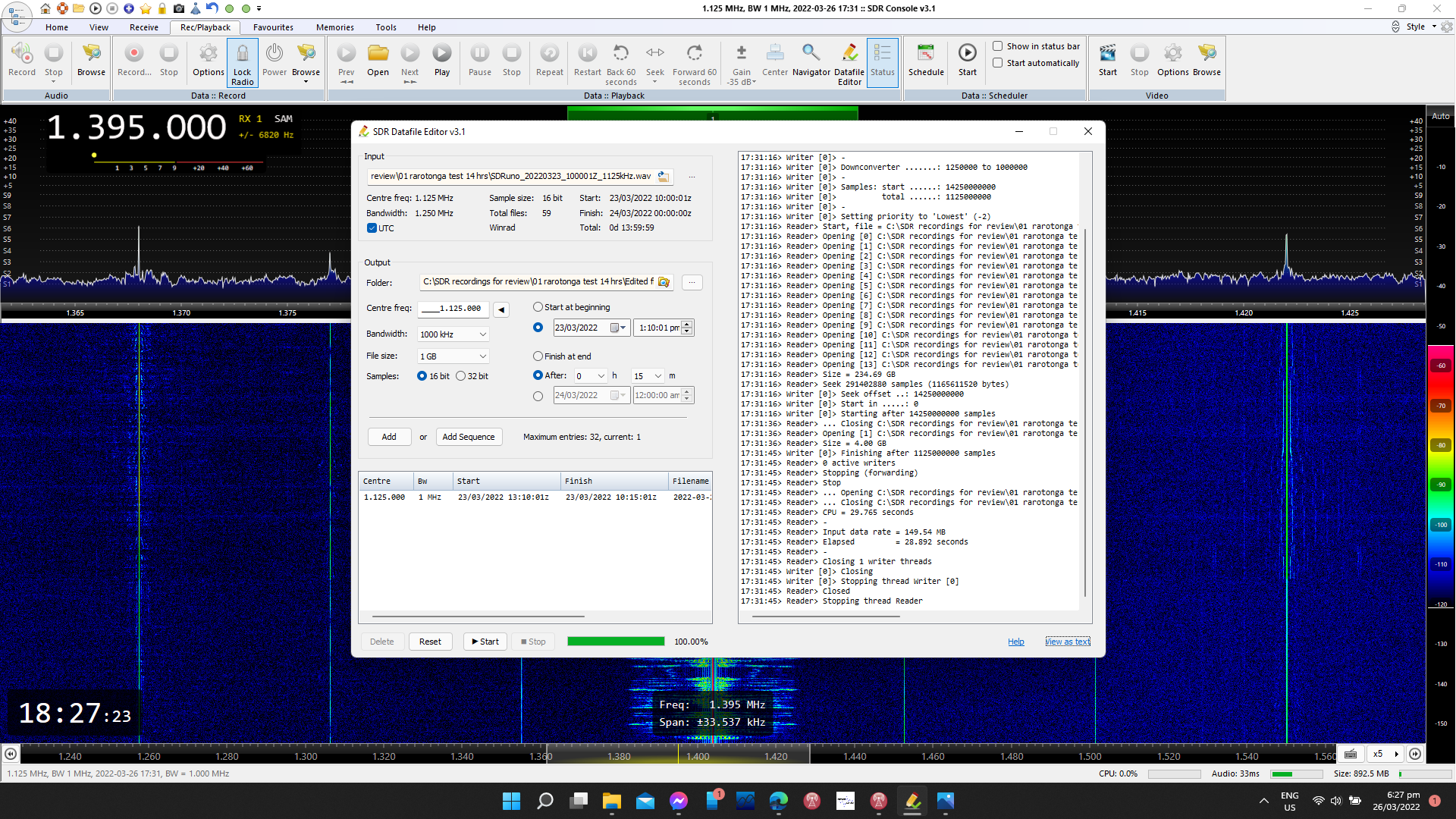

I am having problems editing a 14 hour recording of the entire medium wave band. I was wondering if the file size (234 GB) is excessive and contributing to the issue.
Later in the year I intend taking the SDR on a DX trip, leaving it to record all night and next morning run the Data File Editor to pick out 5 minutes either side of the top of every hour for station IDs. I am trialling this idea today using the Data File Editor, and chose a random time from a 14 hour recording, with a finish time set at 15 minutes.
Playing back the edited file, ten minutes into the recording I noticed it jumps forward by about 5 hours. The recording started at 2.10 am, and at 2.20.27 am it jumps and the time on air is given as 7.15am (video attached).
The original recording was done in SDRuno in 4GB file sizes. Playing this back in SDR Console results in a smooth transition right through without jumping. Looking at the times on the original files, the Data File Editor has taken data from the 2.06am recording, but has not used the next file in the sequence at 2.20am.
Any ideas on this? I've provided a few screenshots as well as the data editor output file to help track the problem down. Thanks again.

I just noticed in the Data File Editor window that it has a starting time of 13.10 UTC but a finish time of 10.15 despite setting the duration as 15 minutes. Should this not read 13.25 rather than 10.15?

I'll look at this, I expect it's a problem working out how the files are chained, also you must not playback a recording while running the editor. Best would be to make the recording with Console.
In the first screenshot click View as Text - let's see the full logfile.

Full logfile has already been uploaded for you.
