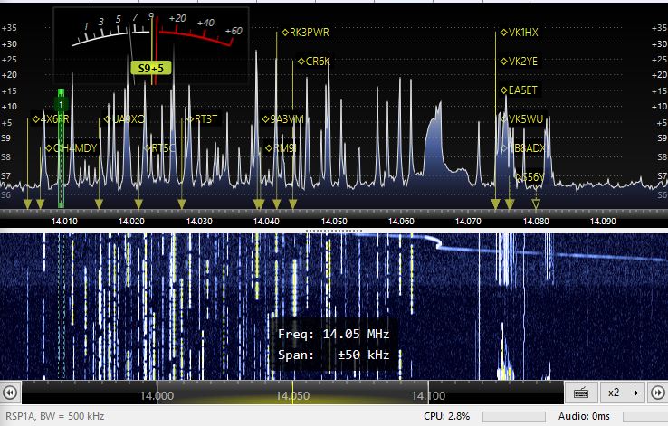

When I start SDRC, it shows a span of +/-50kHz.
Is there a way to make it start up with a span of +/-10kHz?
I suppose my questions are really:
How do you change the zoom?
and
How do you make the change stick?

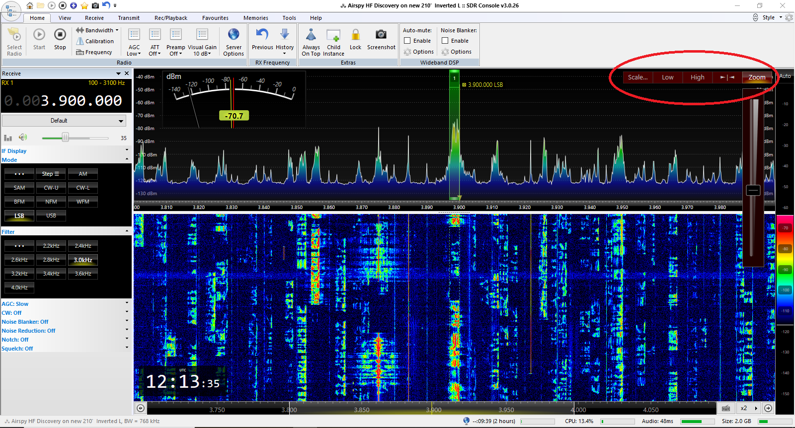

When you move the mouse anywhere on the bandscope or waterfall, five options appear in dull red in the upper right of screen. Scale, Low, High, >I< (Center),and Zoom. If you hover over the Zoom, a slider will appear just below it and you can zoom in and out , 200 Hz to whatever bandwidth you started the SDR with.
Upon shutdown, those settings are saved, frequency, mode, viewable bandwidth, etc. When SDRC is started again, the setting are used and display is right where you left it.
