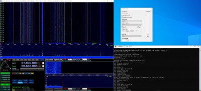

Maybe i'm missing something here but i'm not looking for a wider filter, i'm looking to sample (or view) a wider area of the radio spectrum at the same time.
Basically an option to define a custom bandwidth here instead of having to select one from a predefined list:
