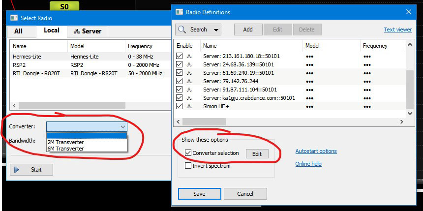

Hi,
I've been using SDR-Radio with three different transverters, each transverter has a different up-converter off-set.
It would be good to have memories for different transverters, that would prevent the operator to type in the frequencies every time
he changes transverters. That could be in the External Radio Options/Up-Converter and buttons outside in the main User Interface for easy access.
Thank you for your excellent piece of software
All the best to you and 73
Flavio Pohlmann VE2ZFP
Posts: 866
Re: easy access transverter buttons
Hi Flavio
This is already present. You need to go to the "Select Radio" dialogue, then press "Definitions", enable the tick box "Converter selection" enter and then edit and name the different offsets required. See attached picture:
73
