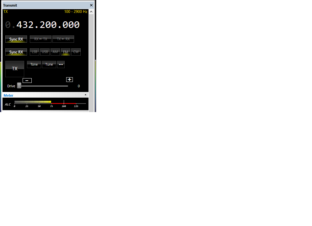

please consider adding two buttons, + and - , near the drive command slider, to be able to precisely increase and decrease the power output.
To prevent possible damage, using the slider.
TNX

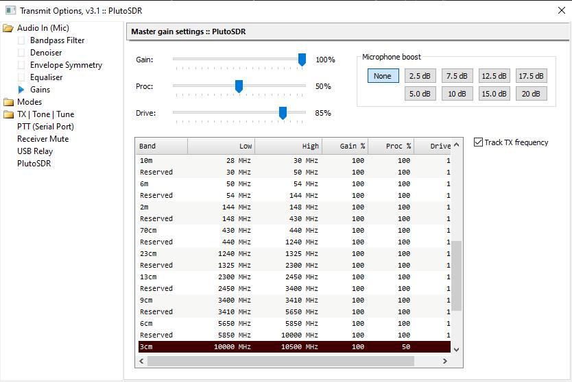

about safety for your amp:
if you go in the tx options and set there the max drive then you can crank it up in the tx tab without danger of damage
(see my example with drive set to 85)
(but the idea of plus minus buttons ... maybe together with a keyboard shortcut for users without a midi deck... is not bad)

Mouse wheel? I can add cursor key support for these sliders I think.
You'll not damage much ...
Re: +/- buttons on pluto drive command
cursor key wil be also ok.
