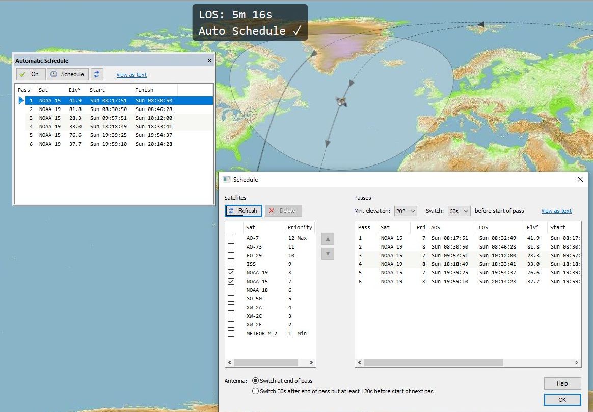

Here is an updated explanation of the request to make the "Min. elevation" function work correctly for satellite passes. The "Min. elevation" that can be set was recently increased to 80 degrees. That is good. However, that unfortunately only affected what is displayed in the two windows "Schedule" and "Automatic Schedule". In the example (below), even though the "Min. elevation" is set at 20 degrees, SDR Console records all passes. The lower elevation pass is being recorded in the screenshot even though it is not shown in the two schedule windows. So, the windows work and display correctly, but the recording function currently ignores the window settings, and records all elevations.

Short summary.
The "Min elevation" should determine which passes get recorded.
However, all passes get recorded regardless of what is set (and shows) as "Min Elevation".

Now if we have min elevation set to 30 degrees we record the whole of this pass? I'll check recording when there's an enabled schedule.
