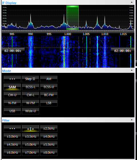

Hi Paul.
I use the "Step" & "Snap" tuning feature for this. When chasing TA-stations I use 10 kHz for SAM (AM) and for non-TA-stations I use 9 kHz.
For SW you can use 5 kHz if you like.
For other modes you can set other values of the step parameter.
See attached screenshot.
With this there is no doubt about the TA and non-TA. Works fine.
73 / Ingolf, SM6FHZ

Hi, Ingolf, thanks for that.
I can see that would help some, so will try it out more thoroughly.
Paul
