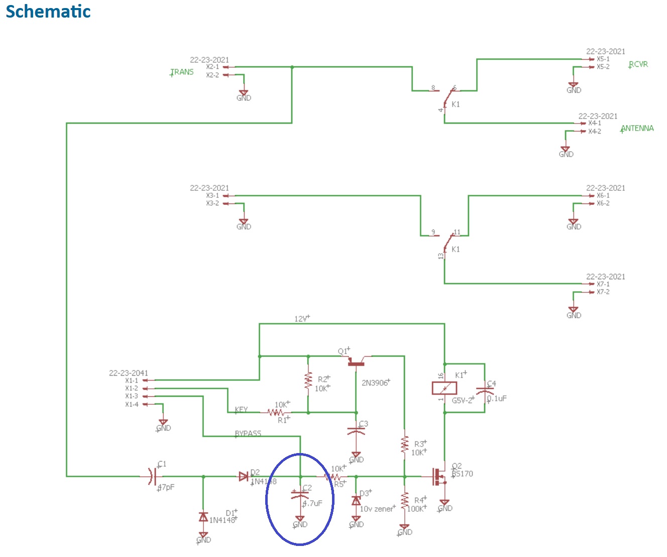

Hello Leon,
this is the setup:
RX: SDR Play RSP1A
TX: TS-480S
Splitter: Easy TR Switch from the QRPkits dot com website.
You can see the ugly feedback I get on my streams. I try to mute by adding the auto-mute feature, but it works intermittent.

Re: External Radio Options extra feature request
ahh ok Kurt, cute little switch. I suppose you're using the RF sense on it, does it switch faster when you're using the manual input?
How do you use the relay contacts on it? 1. RX signal passes the switch when TX is off? or 2. short the RX antenne when TX?
2 seems to me a better protection for the RX as long there's no delay in switching ofcource.
btw when you use the RF sniffing option and the relay has a to long fall-off delay then have a look at this capacitor (4.7u), try to make it smaller.
Hi Leon,
If you want the relay to hang a little longer, I guess the higher value the capacitor should have?
