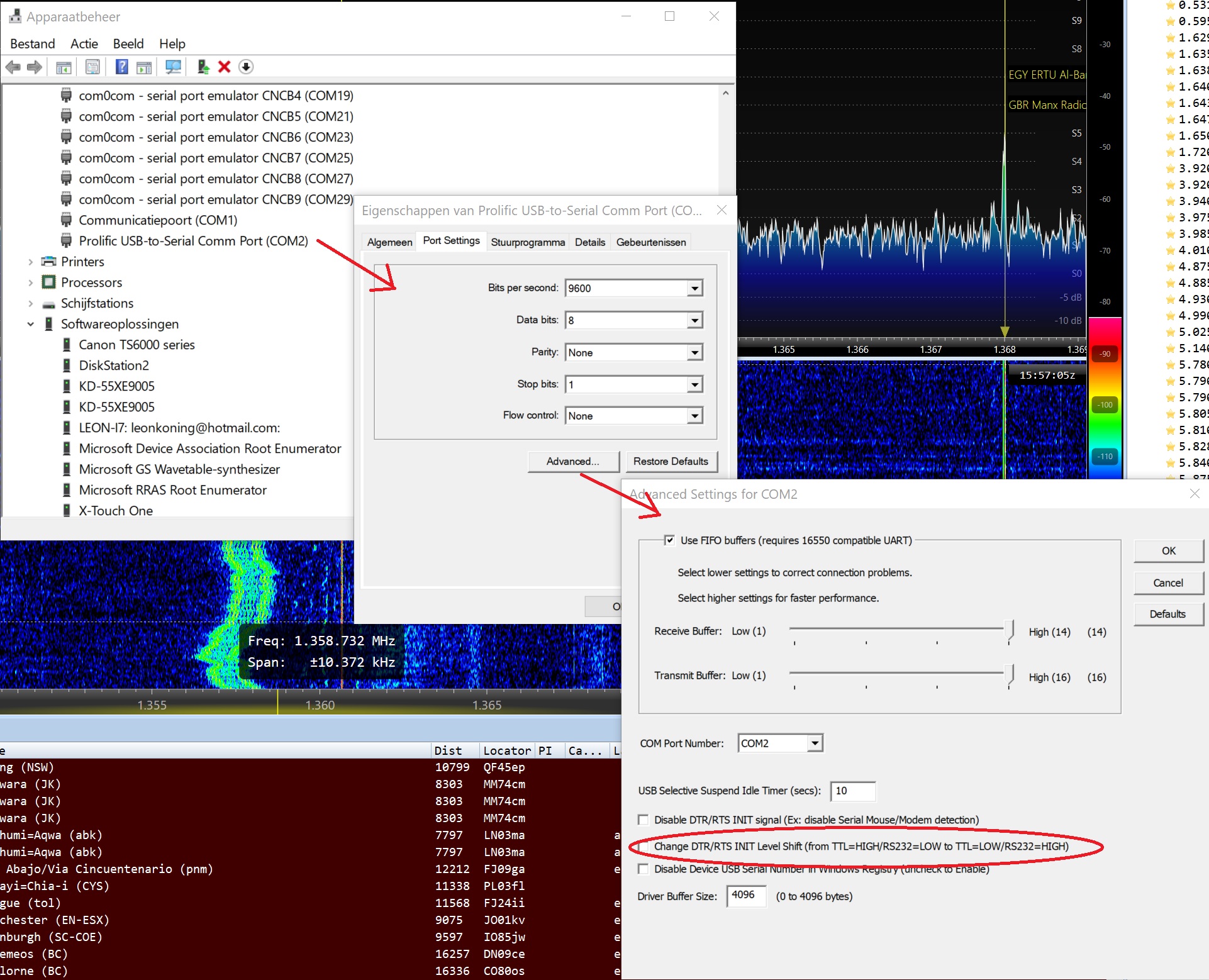

Holger,
If you are using a USB <-> Serial cable with a Profilic chip than there's a option that maybe work's...
See this picture, the settings beneath the Com Port Number setting are proberbly not visable when you use a serial ports on your motherboard.
With my Profilic cable it shows these extra options. Hope to hear if this was helpfull.
73, Leon
73, Leon
