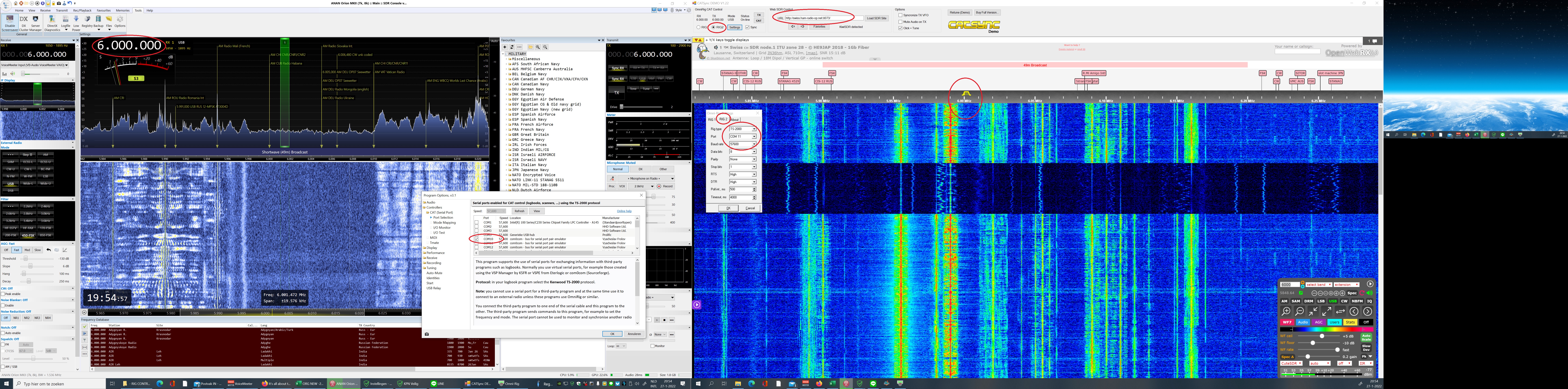

Works great, CATSync let a web KiwiSDR follow the tuning of SDR Console.
It uses OmniRig to connect to your analog rig or SDRC (by TS2000 protocol), see attached picture.
Video:
Documentation and CATSync download link: http://www.kiwisdr.com/quickstart/#id-3rd-party-ext
